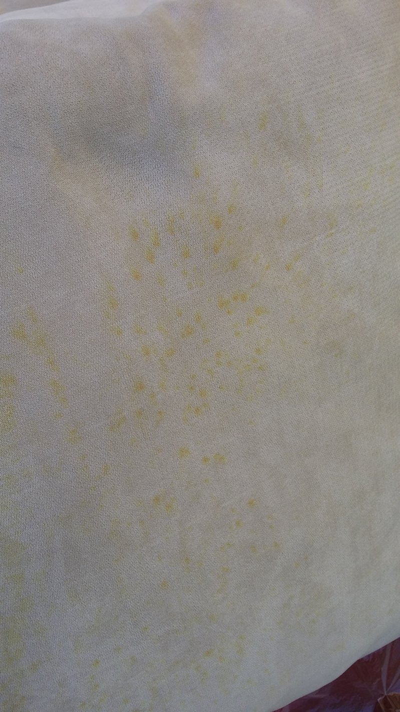

Yellow spots on uph, whats your 1st guess?

I cant be positive but I think the spots showed up after we pre sprayed. Can't see how we didn't see it when dry.

I have seen similar spots on carpet from dried and dyed flower arrangements hung on the wall. Every time a door was closed, tiny bits would fall on the carpet. We wet it and they blew up!!
In cases like that, I use a light and magnifying glass to see if any particulate residue remains. If you can find any, it helps to prove to the customer that you didn't do it as well as helps in crafting a remedy to correct it.

If it is pollen I would be surprised if peroxide didn't take it right out. Lightly mist it and let it set then rinse.

My first guess is usually bug damage. I then just try Encap02 boosted with Aquasilk peroxide and lightly rub it down before cleaning it.

I would use some of my haition cotton extraction emulsifier that I have from bridgepoint. Mist on and vac off.

Mix sodium bicarbonate as strong as you can till you can't get any more to dissolve into solution.
Put a drop of it on one of the spots and let me know what happens.
