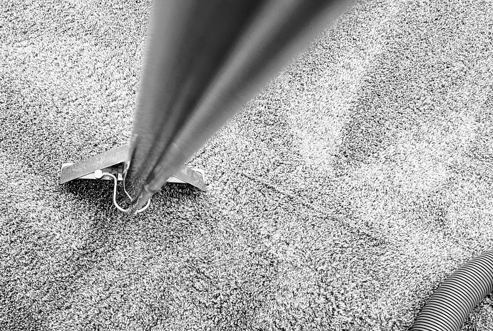

Jun 8, 2023 #1 Mikey P Administrator Joined Oct 6, 2006 Messages 117,020 Cut the center support pin out, it's a hair hanger and unneeded. Reactions: BIG WOOD and Cleanworks
Jun 8, 2023 #2 BIG WOOD The Timminator Joined Feb 4, 2016 Messages 14,525 Name Matt w. I was just thinking that last week when I was pulling a ton of hair out of it. Are you sure it won't hurt it?
Jun 8, 2023 #3 Mikey P Administrator Joined Oct 6, 2006 Messages 117,020 BIG WOOD said: I was just thinking that last week when I was pulling a ton of hair out of it. Are you sure it won't hurt it? Click to expand... internal fit glide keeps it from collapsing Reactions: SamIam, BIG WOOD and Cleanworks
Jun 8, 2023 #4 Mikey P Administrator Joined Oct 6, 2006 Messages 117,020 Adam Hale bought one too Super impressed Reactions: BIG WOOD and Cleanworks
