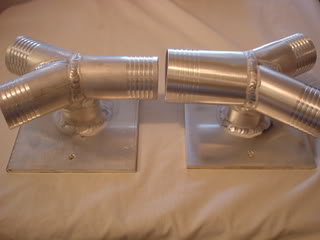

These are my mounted Ys both 2" and 2.5", designed to be your new "hook up" point at the machine, easily bolted to floor or side of machine.

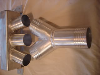

This is my new 2.5" Super Y shown next to the vac manifold, it's 2.5" on all three sides.

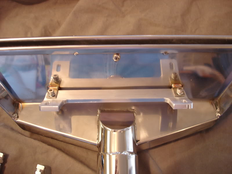

Here is the bracket that is the base for converting a CMP wand with a Greenhorn kit.
notice it just bolts into the factory CMP mounts.

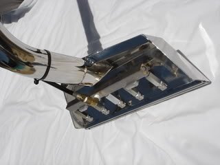

Greenie
6,820

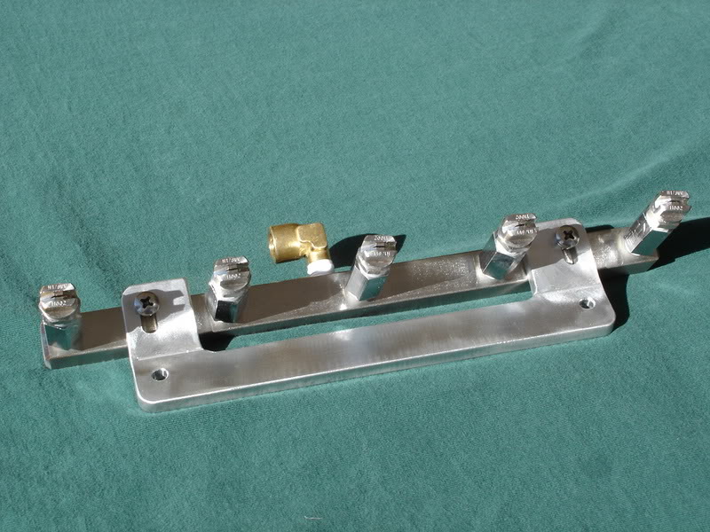

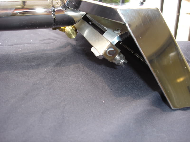

Now I have added a 5 jet manifold (most wands come with 4) and 5 GreenGlides check valve jet extensions, and 5 11002 jets.
This manifold places the jets at a 45º to the carpet.
Next I add a thermoplastic solution line.

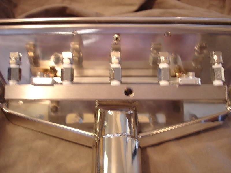

Greenie
6,820
Here is the assembly free standing:

6,820
Overall shot of Greenhorn kit:
This one is what I call the commercial kit, it has the longer check valve extenders, most guys opt for the shorter ones in residential.
Greenie
6,820
Close up, no check valves installed:

danggggg looks nice....whats the vac manifold??
also i needs at least a 3 jet for that stupid work master one...
Greenie
6,820
yea 2 jets on a 14" wand, what were they smokin'?
The vac manifold is better illustrated in the V/AT thread, it's for connecting 3 two inch hoses to two 2.5" hoses.

yea i then saw that over there and felt stupid....soooo got any ideas for that manifold??? i tried making my own but ehhh stuck out to far and got to close to the wand...wouldnt work...
btw that glide is working out slick...i kinda like to be able to take it off if needs be
Wandslinger
1,006
Simi Valley
Tom Meyer
What's the make up of the solution line. It isn't one of those cheap psi ones that the Sux12 comes with is it? The wand looks great and how easy it looks to fix.
