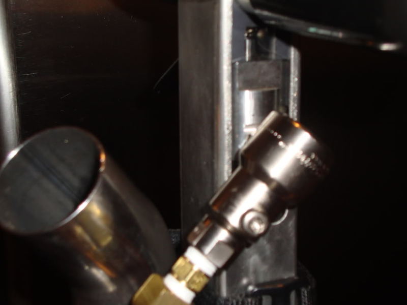

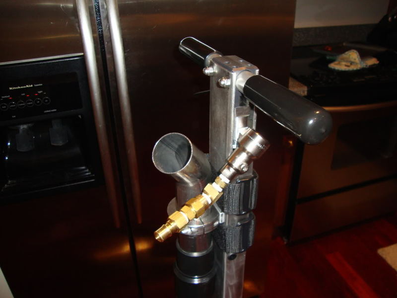

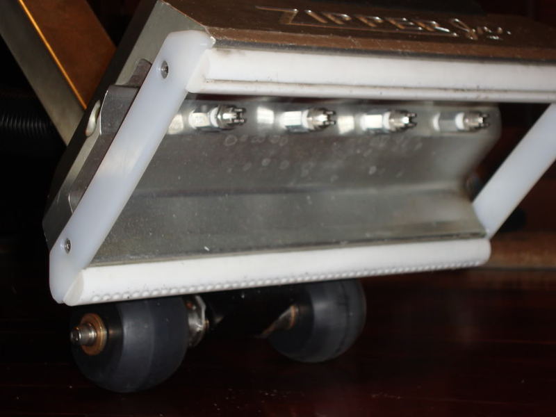

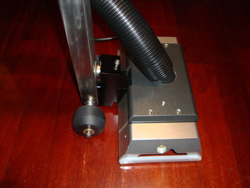

Thanks for the great review Eric. I have the Zipper jr. almost ready for MF. I'm picking up the weight package tomorrow. We are running a 12 flow 4 jet manifold, Precision fluid control valve. Everything is easily adjustable right or left handed. Thanks to Harper the wheels are easily adjustable, for padded or CGD carpet. Here are a few pics of the changes:
