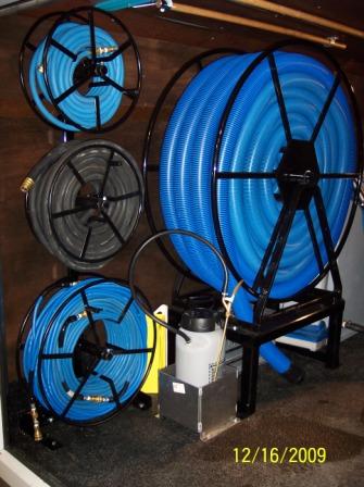

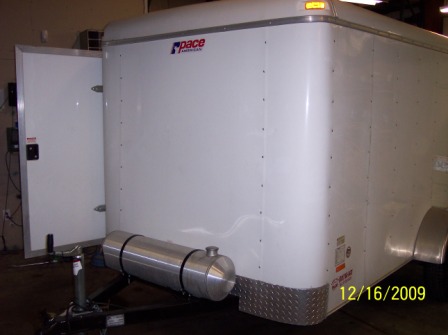

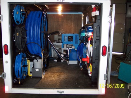

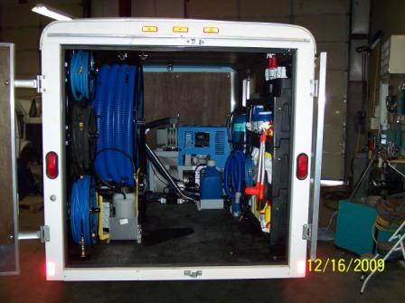

Here are pics of my new Rental Unit. We put the 370SS in a 6x10 Trailer.
We insulated the walls and the cieling with 1/2" Foam the added the paneling. We wired in two cheap head lights from Wal Mart that give off plenty of light. We also Insualted the bottom of the trailer with 3 inch Foam. The floor we lined ourselves with Herculiner (2 coats). On the front we use a 11x40 13 gallon spun aluminum dune buggy gas tank. Hose reel stands are custom to the hose reel and the unit they are installed in. We normally go 4 high with the Mytee shelfs but decided to go 3 and put the bottle holder and the Hydro-Force hold on top.

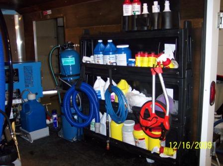

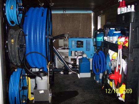

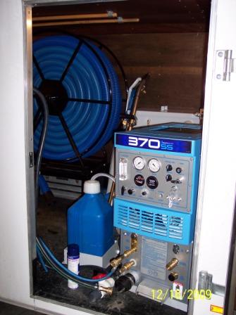

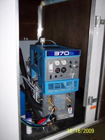

Inside we have the 370SS with a Prochem pump out, water softner, 250' Vac Reel,300' solution reel, 2-200' hose reels for fresh water and dump hose's. 3 high Mytee shelves. Prochem TI wand, (my wife's) PV12 Vacuum, tool box, Grandi Groom and Grandi Brush.
We had to installed the machine a little cock-eyed because of the waste tank design. It was designed with the thought of going into a van. If it had been a standard tank we could have utilized more room but we still made it work and have a TON of room left in this thing.

Cool gas tank, gives it a nice clean look, plus keeps weight up front....very nice.

looks great, how come the vac hose reel is mounted so far off the ground?? how much is the rental going to be on the unit. that is great to know something like that is available around me.

Steve we raise the hose reels to gain space. With the hose reels on the ground you lose all the space above the reel. By Raising it you gain most of it back. We put the tool box under the reel and the door jam then bungie the Airpath next to it. We just delivered a bunch of airmovers to service master. We put 12 airmovers in the boxes in the trailer and that was only double stacked. I bet we can easily put 2 2800i's and a dozen or more airmovers in there.

are there any special DOT requirements for the gas tank? I like the set up. I've been thinking about getting a trailer setup.

None that I know of. We have been putting these tanks on trailers for as long as I have been doing this. These tanks can take a beating. They are made for Dune Buggy's after all.

One other thing the guys in cold weather will appreciate. We took the machine out last saturday to clean Lora's Uncle house. Temp was low 30's outside and snowing. We drove to South Jordan (35 minutes away) and the inside trailer temp never dropped below 60 (remote sensor readings) with NO heater inside. The boys in the shop did a great job insulating this thing :) I am into it quite a bit I wouldn't sell the trailer alone for less then 4500 with all we have done to it.

Very nice John. The one thing that might we worthwhile doing is to prime the walls in a light grey so it has more light to see in there. I find inexpensive porch and floor latex paint a good thing to put on.
Very well thought out design. Any idea what the whole thing weights?

Bob the boys stained the walls that color. No way am I going to suggest to the boys to paint it. They have Bern working hard on it. I'll take updated pics today when the get the last of the paneling done and the other shelf up.

Bill Martins
Looks great.
Do you prefer the black shelves rather than the blue?

What did you do with the powermatic that was in there ? Or is that a new trailer from the first ? If its the same, I installed the hose reels... sorta. :mrgreen:

Sold the powermatic. This one is all new nothing used. See u tomorrow.

How does the trailer handle on the road at speed? I know the TM is small but in a single axle trailer you really don't want to exceed 10-15% gross weight on the tongue. In a 1500lb capacity trailer(my 6X12) really about 200lb tongue weight max. It can cause serious handling issues.
John Olson
6,281
Orem UT
John Olson
Drives easy. If I was to put a bigger Machine in I would go to the tandem axle with brakes but with this machine we are not even close on having a weight issue.
