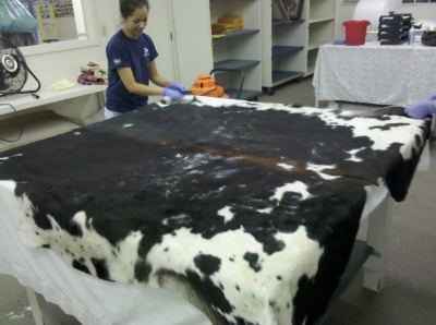

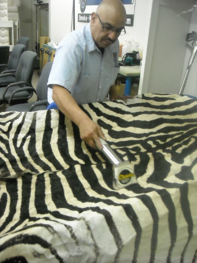

If the hide is in OK condition: no mangy areas, soft hide, no tears or cracks, we'll use a low moisture furniture tool to wet clean. If subject to a lot of use we'll wash them in the Moore machine. If the hide is real dry you'll need to charge enough to cover the amount of conditioner a hide can soak up.
We had some arrive in garbage bags, solid with mud from a Montana cabin flood. Washed up great.
