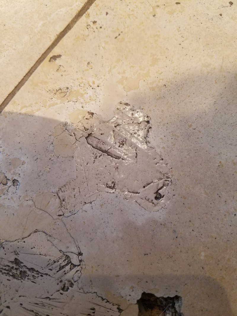

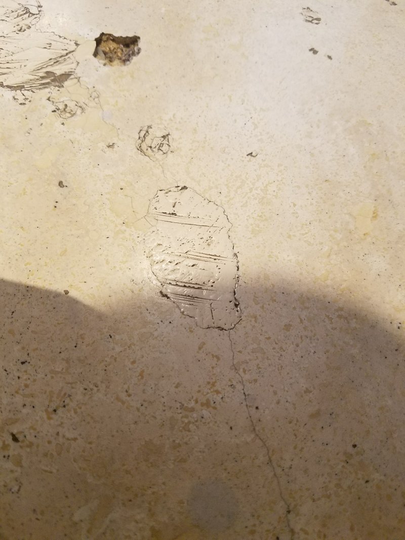

Anybody dig out old epoxy fill ?
Wandslinger
1,005
Simi Valley
Tom Meyer
Custy wants the old stuff out and some new epoxy in. Rob Fairfield recommended a dremmel. I can only imagine the pain involved with that. Suggestions?
Onfire_02_01
Jan 2, 2016
767
Minnesota
Jeremy Gray
The Dremmel would take way too long. I would suggest a cement saw and cut a square, use an impact drill to break up the square you cut out, then patch the hole.
Alternatively you could use an impact drill to drill out the previous patch and there are various tips you could use for a sawzall that would chip out the rest.
Reactions: Wandslinger
Onfire_02_01
Jan 2, 2016
767
Minnesota
Jeremy Gray
Didn't realize it was a tile. Yep take out the tile and put a new one down. Assuming he has any left. Otherwise a similar tile or a patch would stand out the same.
clean image
Oct 5, 2012
969
Orlando
Carl Maddock
Needs was I refer to as a level 5/5 hole repair
unless your proficient with hand machine and have light grinding tools, Genesis 120 or such.
Basically problem isn't the epoxy, it's the fill technique. Needs multi color, overfill and grind flat, then blend
Option 2 replace tile has its own skill set
