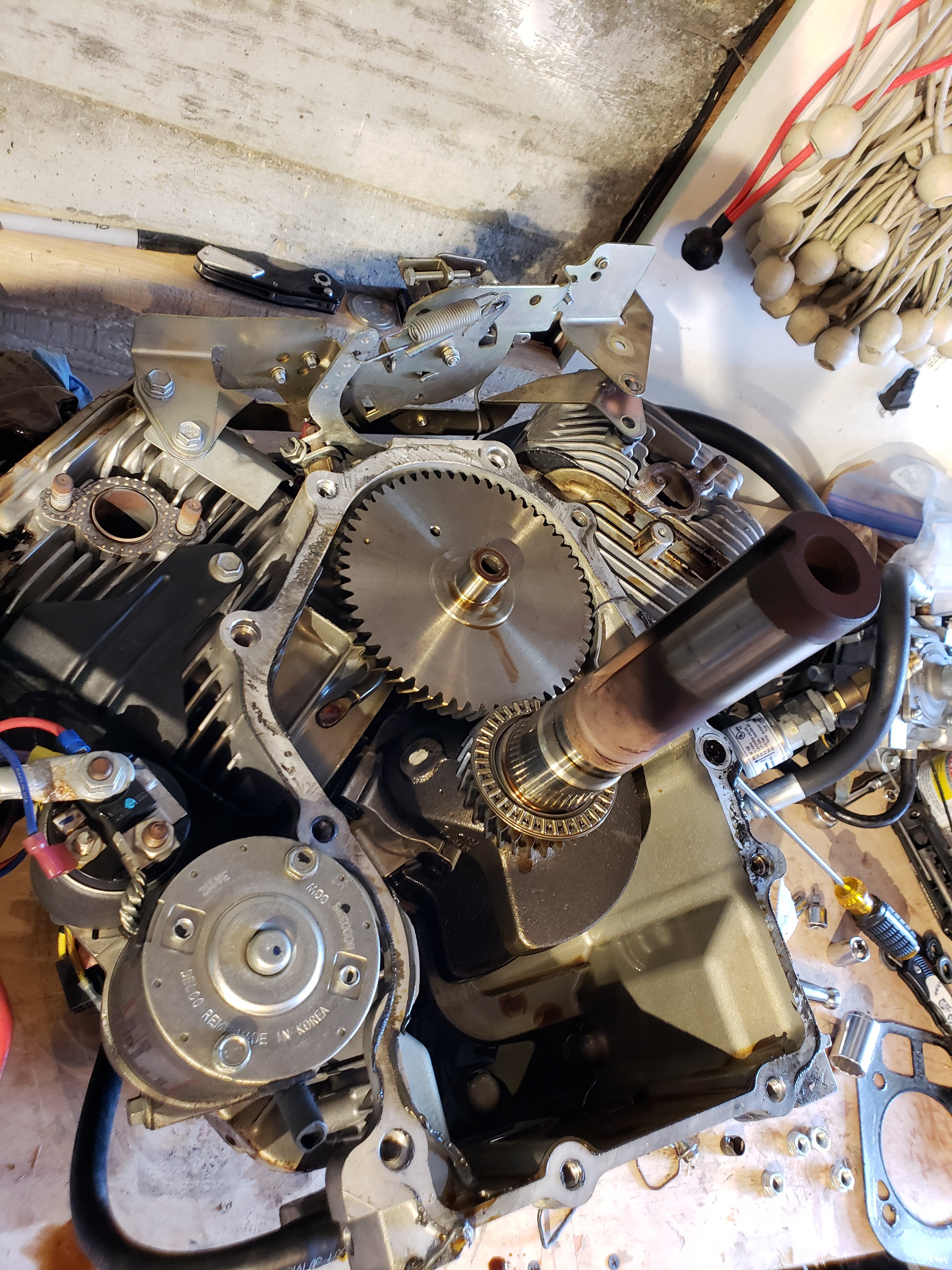

    My trusty old Kohler with somewhere around 8000 hours on it has finally given up the ghost, she started spitting a bunch of oil out of the breather in the past couple months. She’s still running but it’s just a matter of time so I ordered a brand new one. I’m thinking of buying a rebuild kit and keeping the old one as a spare cause it’s got a bunch of new parts that were replaced in the past year, anybody ever use a motor that had been rebuilt?

    Yeah, Steamway used a version with a larger crank and a 25 amp charging system so they’re a lot more. You can buy them for 1500 with a smaller crank and 15 amp stator. Unfortunately there were so many hours on it my mechanic said it’s basically a boat anchor, I’m gonna pull all the new parts off as spares and scrap it.

    just did a ton of work on my kohler 25hp. Both head gaskets, push rods, new hydraulic lifters, etc
    had same thing was leaking bad out of the rebreather. Your at 8000 hrs thats a lot but I would still weigh the option of rebuilding it. Mines running like its brand new now and total cost was I think around $200

    If I did it I would do it right, but the engine guy with 30 years experience and my mechanic with 25 years experience said it’s not worth it because of the amount of hours. My mechanic said I’m actually closer to 9-10,000 hours on it so she had a good run!

    I still think its worth a shot to at least fix the leaks... I can tell you that my $200 and 4hrs spent was very worth it.
    I dont have as many hours as you, but considering you could have it probably running just fine for a small investment I would go for it
    forgot to mention I also did crankcase as well which is just RTV, the head gaskets are like a $40 part, lifters were about $70, push rods $45
