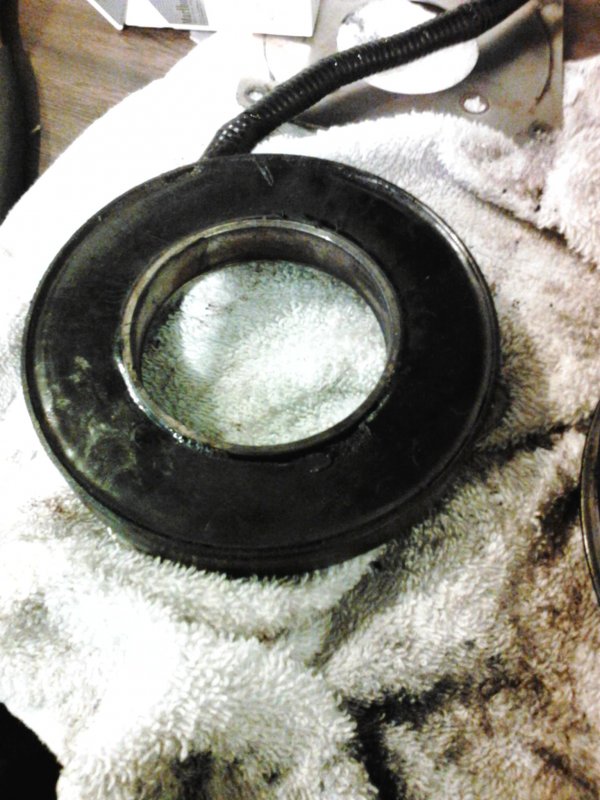

Compression is good up over 200!! I'm going to run it and see what the motor has.. He said he put a new clutch on it, I'm not an expert in clutches, but it looks fried to me..?
Fort Worth , Texas
That is not the part that usually fails, the part of the clutch assembly that usually fails is the flex plate/contact plate as is doesn't have the original integrity to flex back out after the charge has been released from the magnet.
