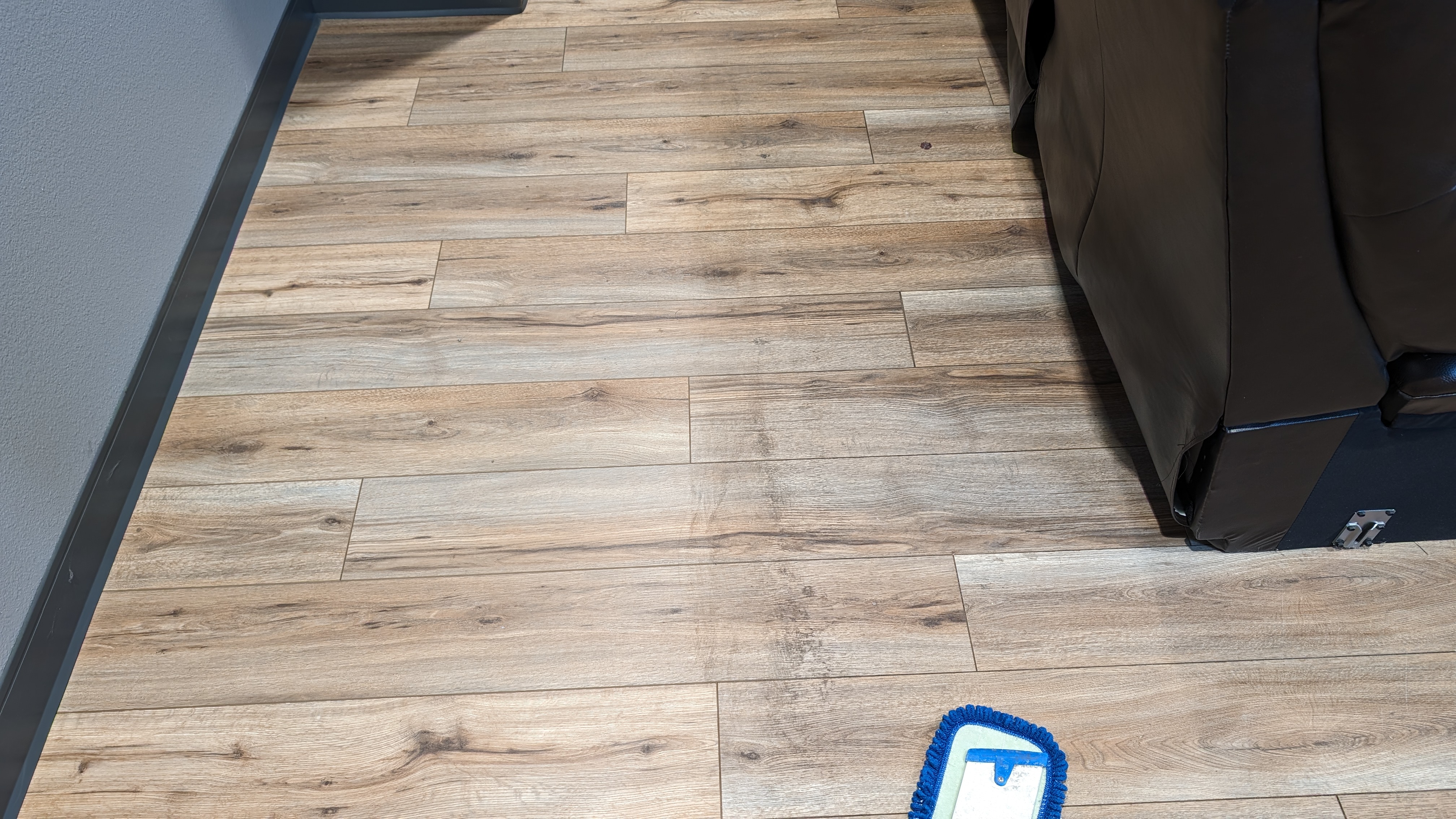

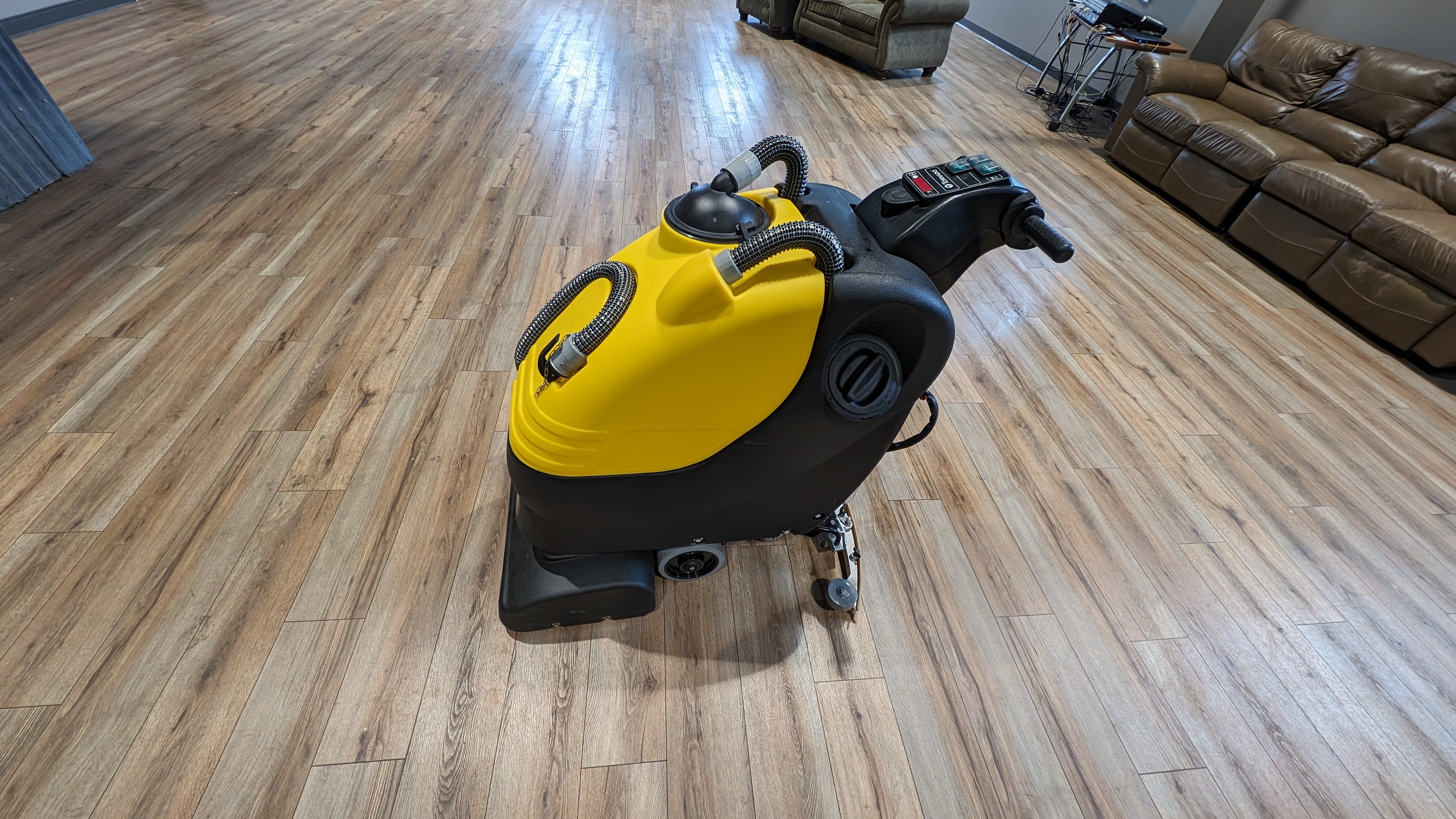

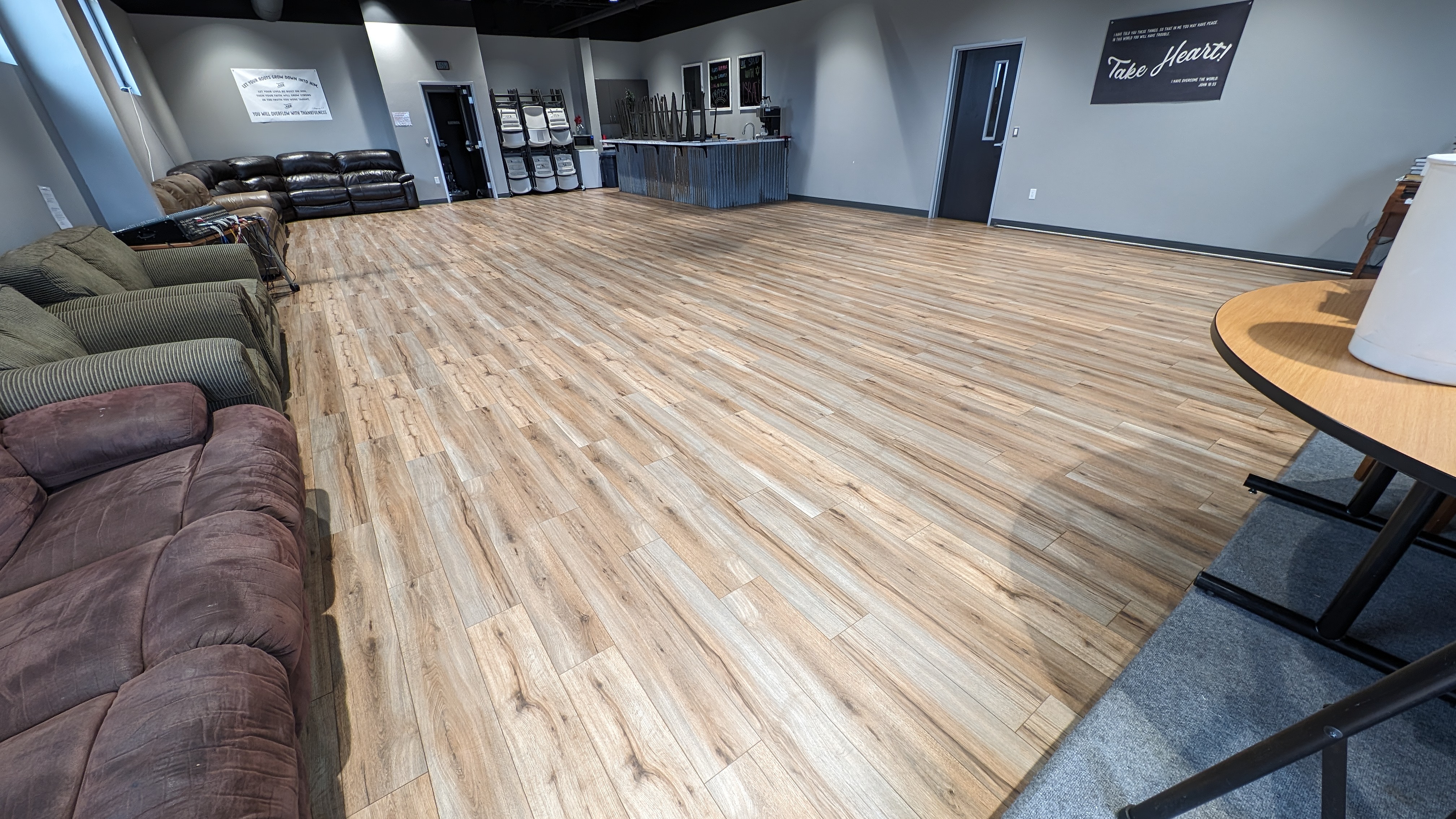

This LVP floor at my church could have been "wanded" but I chose to try their walk behind for the sake of evaluating the process.
Edges, nooks, around furniture, corners all needed cleaning by hand and the whole project took PXL_20240122_175642256.jpgPXL_20240122_182712987.jpgPXL_20240122_195553106.jpgtwice as long as I if had used my truck out and HS wand..

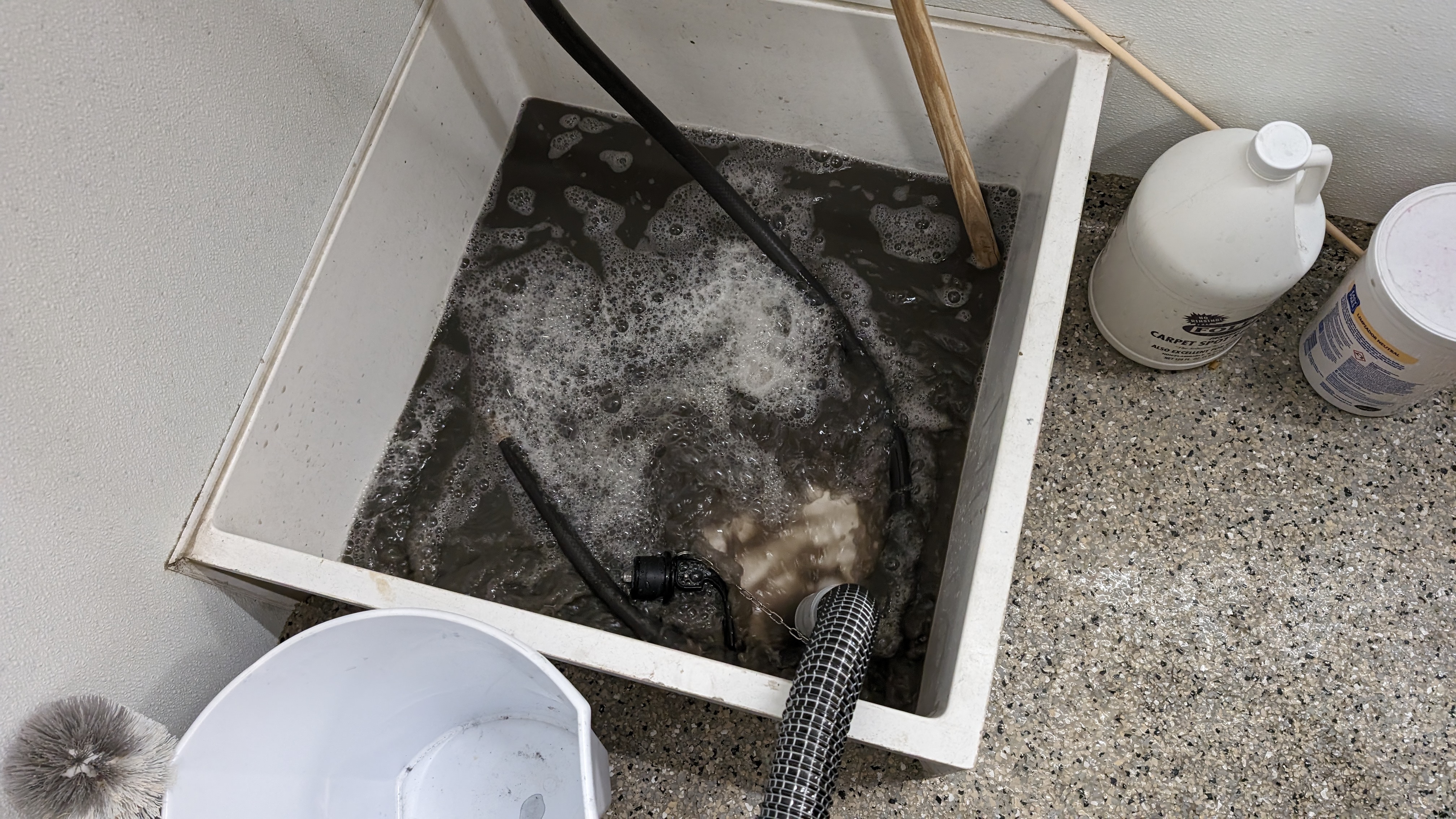

But as you can see, it worked well when I pre-moped an area with a heavy alkaline.. PXL_20240122_200547804.jpg

You need more practice! A foot on your mop will get the corners just fine. Along the edges as well if needed. Your scrubber looks to be a cylindrical brush model as well. They usually don’t have the head pressure to do as well as regular auto scrubber.

Rougly 2000 sqf. ? I'd love to hit it with my Tenant T1 with
IFT from Basic coatings, one tank if solution would suffice, na drying, no wiping, corners debatable. Maybe two hours in very slow pace. I love cleaning wood, laminate or LVP.
Auto srubber is more advanced than I -Robot, but nothing can compare to straight overlap passes of push- self propelled machine
I've seen Auto scrubbers in warehouses do a decent job.

Somebody suggested that I should have used a two pass (wa;l behind) process, one wiht the vac off but shower feeding and dual brush scrubbing, allow for some dwel time, then another pass wiht the vacuum on
That would have made a heck of a wet mess.....
The individual that suggested this hasn't much field experience I'm sure...

No, it’s true for a deeper scrub. It would be like stripping a floor. The only prob with that machine is the cylindrical brushes don’t do as well on an auto scrubber. Not enough head pressure. But, that person is correct.

Maybe on VCT, but not LVT LVP. That’s literally flooding it and when water gets under it…

Maybe the dual pass system would work on great big open areas with round corners but I see it leaving way too much standing water during the dwell time.

You can control how much water you lay down, and how long it stays before vacuuming it up. However, since you’re more comfortable with your tm, by all means go with that. Personally, I’d use a regular auto scrubber and crb for corners.
