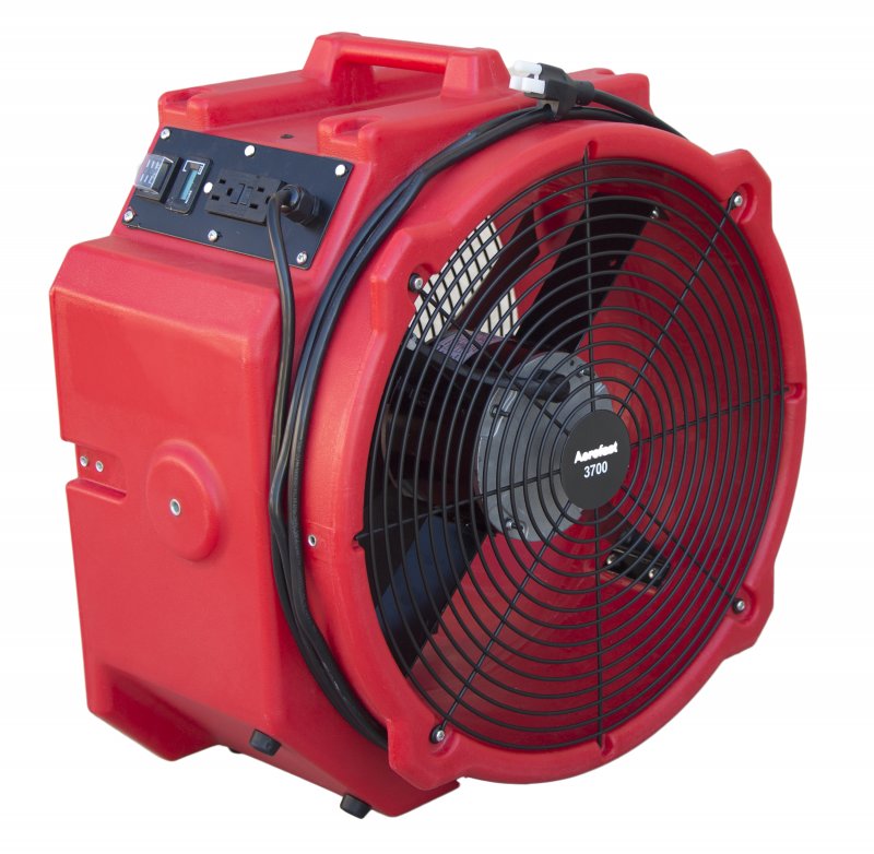

We have an Axial and you can buy at distributor pricing. $189.00 each brand new. Free freight lower 48 with pallet (24 fans) orders. 2.6 amps, daisy chain, hour meter, red color, 3,700 cfm. Stacks 15 feet high for storage. 602-723-2534

I have Teal and Blue in 3.6 amp and no hour meter. Just Red in 2.6 amp with hour meter.
Red Aerofast w:meter.jpg
