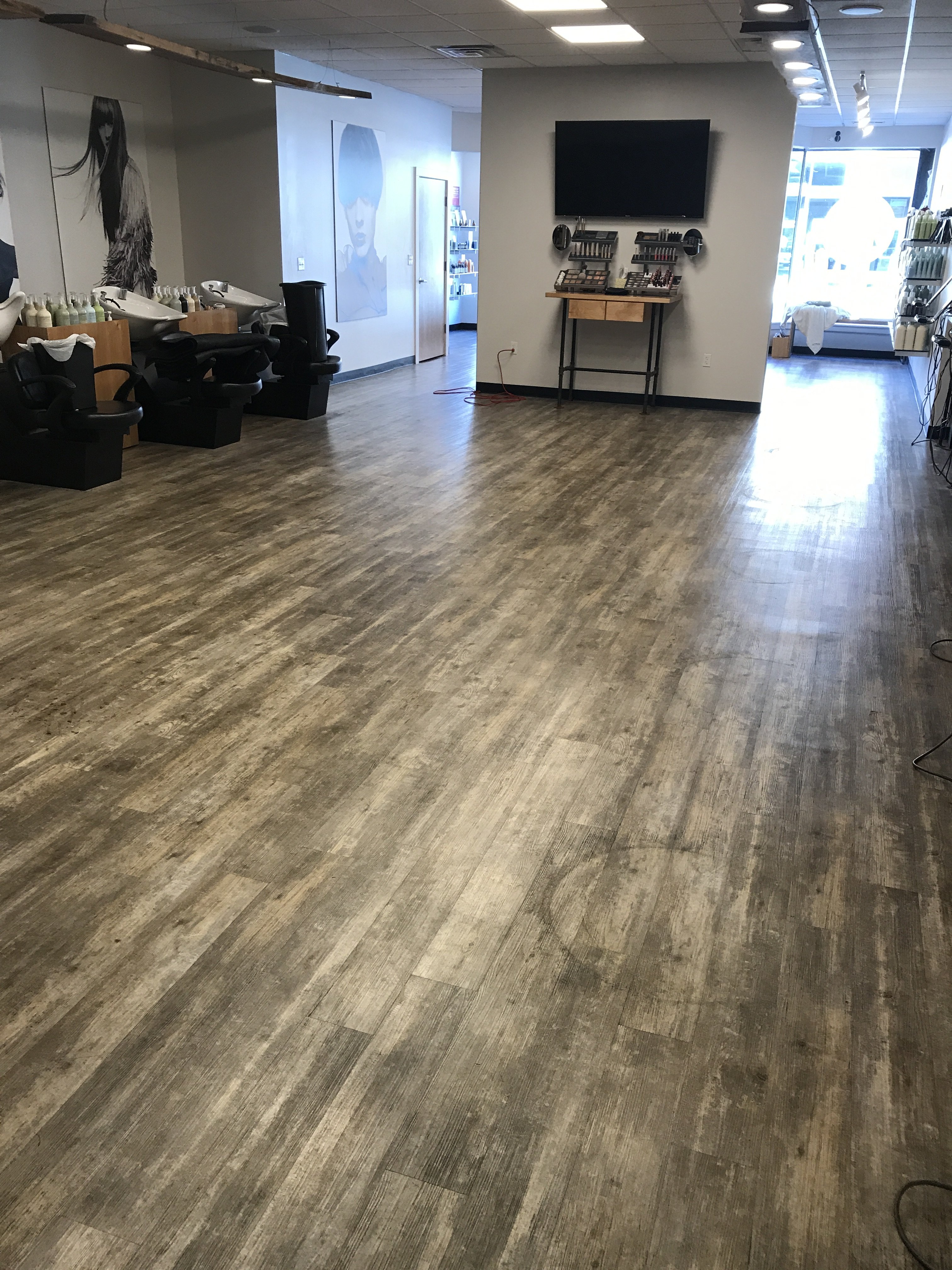

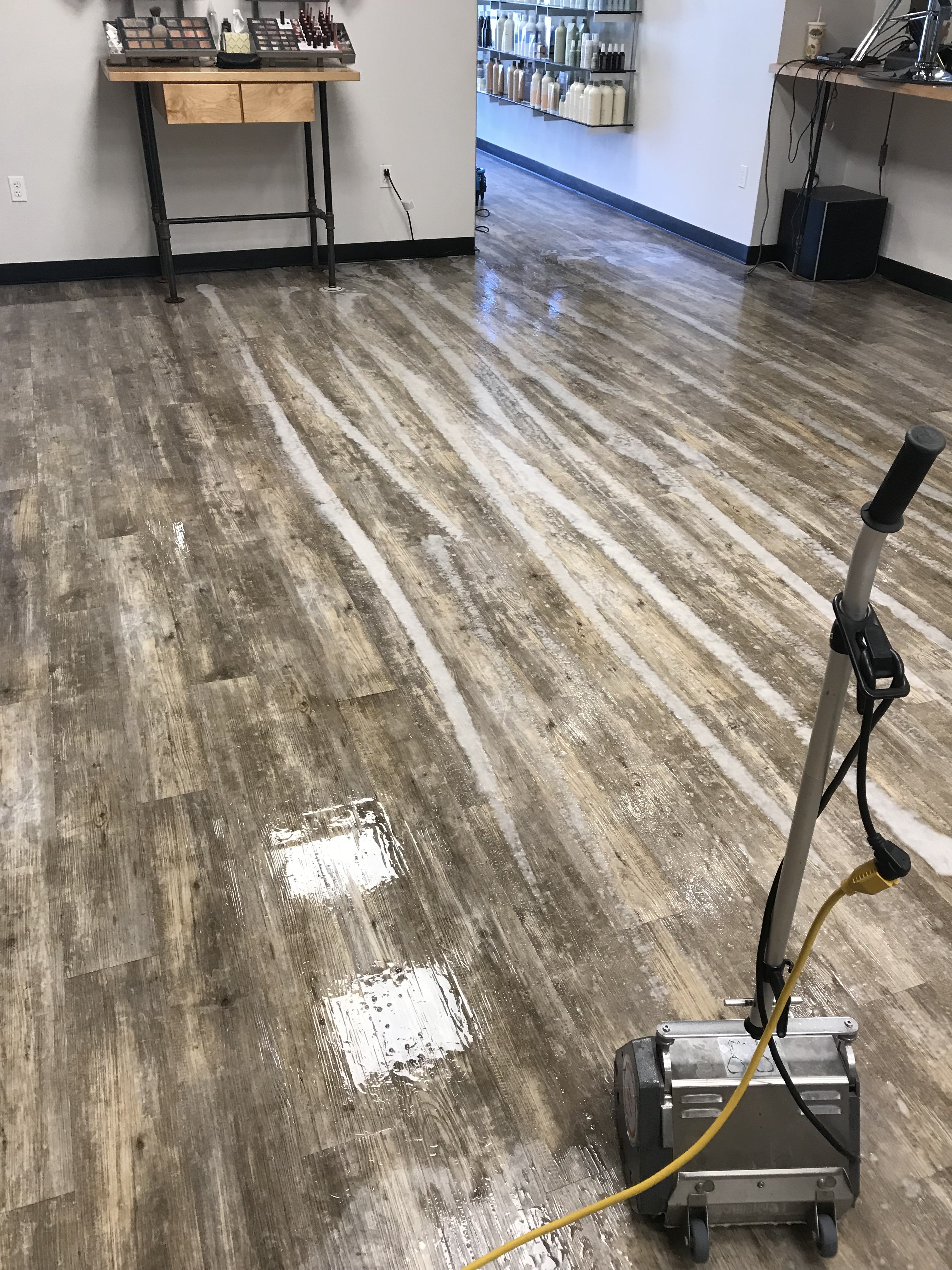

These were the only 2 I got. I was alone so I’m always focused on just getting to the other side of a project. Customer was thrilled. It was a cake walk. Took 3.5 hours alone to really make the salon shine again.

Well that was a piece of cake.
I mixed the Code Red heavy in a hot mop bucket and just watched the soil melt off and was scrubbed with the CRB and held in suspension until I rinsed with the Devastator Wand.
Thanks for the tip guys. That was the easiest money I’ve made in prolly a week :biggrin:
