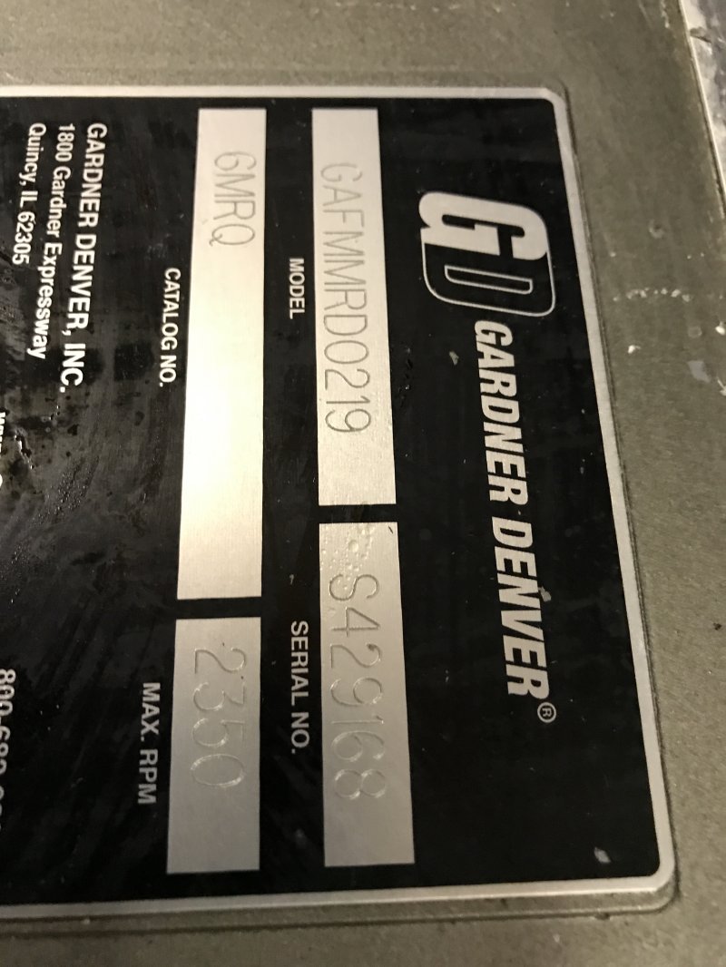

Jun 25, 2017 #1 ronbeatty Member Joined Nov 16, 2006 Messages 1,436 Location Altoona,PA Name Ron Beatty I am replacing the gear end gasket on a Gardner Denver blower and I cannot find the torque settings in the manual. Does anyone know what the torque setting is? Also, what is the best thread sealer for synthetic gear oil?

Jun 25, 2017 #2 FredC Village Idiot Joined Jul 13, 2011 Messages 26,352 I could be wrong but I would assume your model gafmmr would have similar torque values as on page 24 here http://www.enviroequipment.com/site...w/ManualSutorbiltLegend6-8SB-7-622V311-05.pdf Reactions: Bob Pruitt and Lee Stockwell

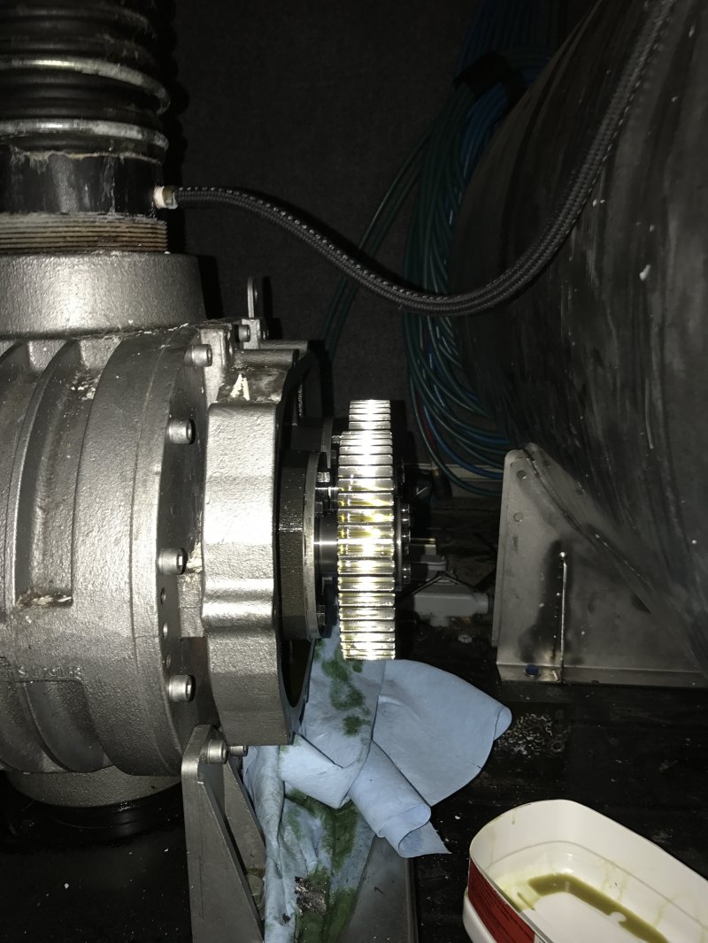

Jun 25, 2017 #3 Mikey P Administrator Joined Oct 6, 2006 Messages 112,588 Location The High Chapperal What went wrong?
Jun 25, 2017 #4 ronbeatty Member Joined Nov 16, 2006 Messages 1,436 Location Altoona,PA Name Ron Beatty Oil leak, the gasket split. Keep an eye on yours, it is evidently an issue with this blower. Got the gasket from Aerotech. Reactions: Mikey P

Jun 25, 2017 #5 ronbeatty Member Joined Nov 16, 2006 Messages 1,436 Location Altoona,PA Name Ron Beatty Thanks Fred, I looked through the manual but missed that, shouldn't be doing that type of work at 11:00 pm. Reactions: FredC
