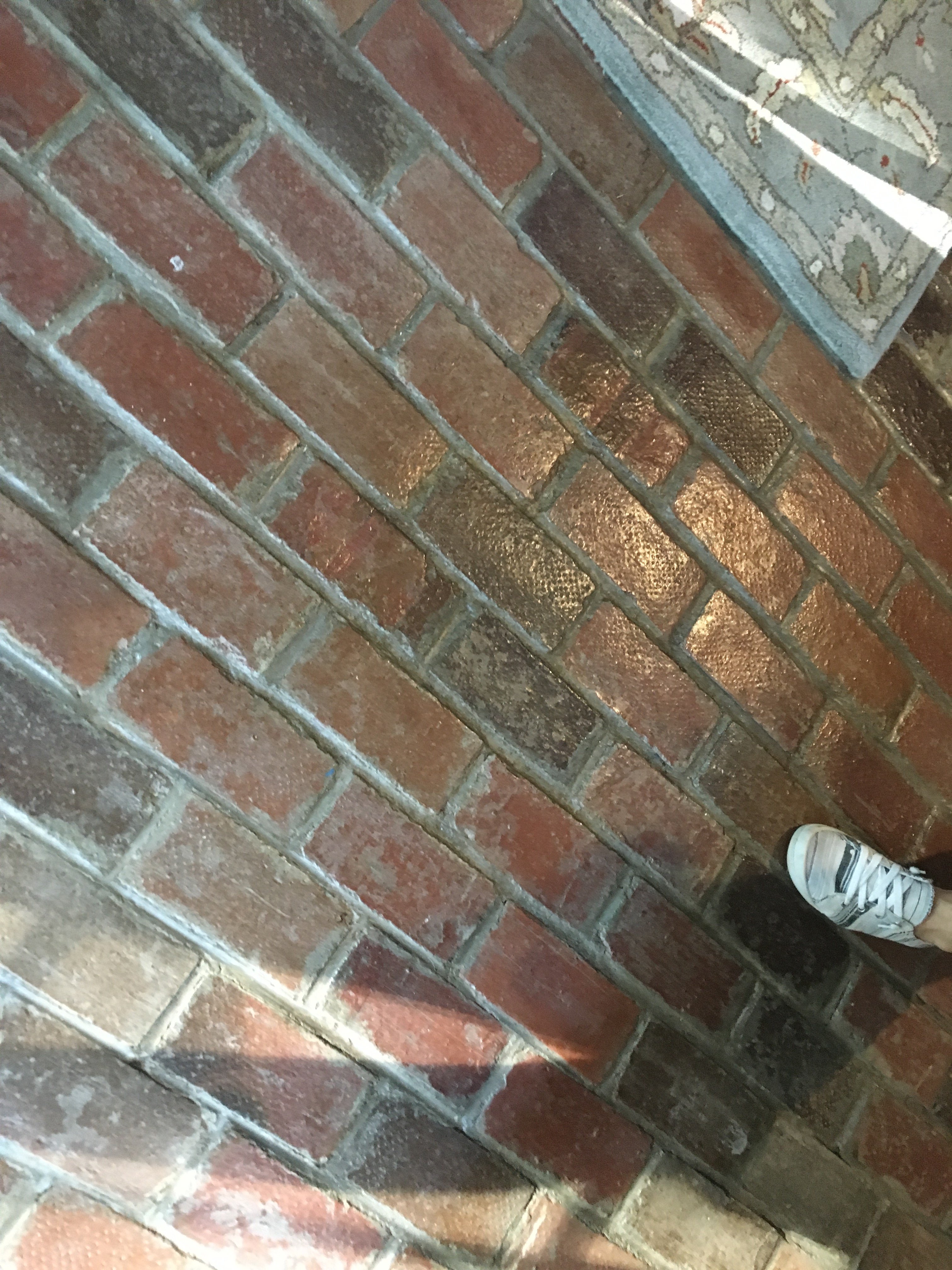

How do I strip this kind of floor and what type of finish do I need to use to put down?

Treat like a Saltillo but that brick may be a lil softer. I would do it , min $3/ft
Blue tile grout brush on a 175 then I’d prob use a green pad if all the tops are pretty even.
Hard as nails is a good finish
What's the average life of that product (Hard as nails) before it'll need stripping again? I see that it's an acrylic based chemical
If they simply clean it properly and don’t re apply any finish on there own it’ll last many years 3-5yrs depending on foot traffic but if you maintain it with a scrub n buff they won’t need a full re strip

And can any of you determine if it's an epoxy finish or a polyurethane? I did an acrylic test and it just made it look shinier.

Yeah, it looks more like a type of urethane finish. He told me that the installer had to wear a ventilator when he applied that finish

Are you determined to do that job?
Ten minutes in I bet he wishes he didn't!
Even if it will scrape off the bricks(one at a time), the grout(or whatever that is) still going to look like poop.

I got an update on the size. It’s 650 sq ft. I’m assuming it’ll take 6-7hrs to strip it from the directions on those type of strippers. I told her that after it got stripped and cleaned, 24hrs after I recommended an impregnator sealer only. Not a finish for this very reason it’s being stripped.
After telling her the price, I think I scared her away from hiring me. And if I take this job, it’ll be a month or so from now
It will take a lot longer than 6-7 hours
