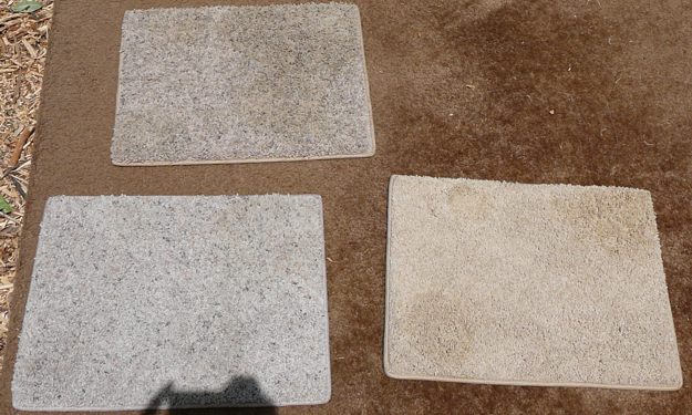

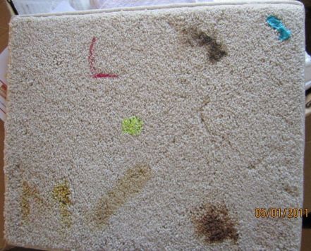

Test carpet with mustard stain ( lower left corner) removed by carpet cleaners using that technique:
Bottom two after UV + oxidizer spotting:
