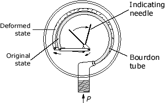

The only reason the plug would dislodge, and fluid would exit is if the bourdon tube is burst or leaking.
The Bourdon Tube is a coiled or curved piece of flattened copper tubing inside the gauge. The external pressure is guided into the tube and causes it to flex, resulting in a change in curvature of the tube. These curvature changes are linked to the dial indicator for a number readout. If the tube leaks, there is nothing you can do but replace the gauge.
The viscous glycerine fill dampens the movement of the mechanism to reduce needle vibration for easier reading, and to prolong the life of the movement.
