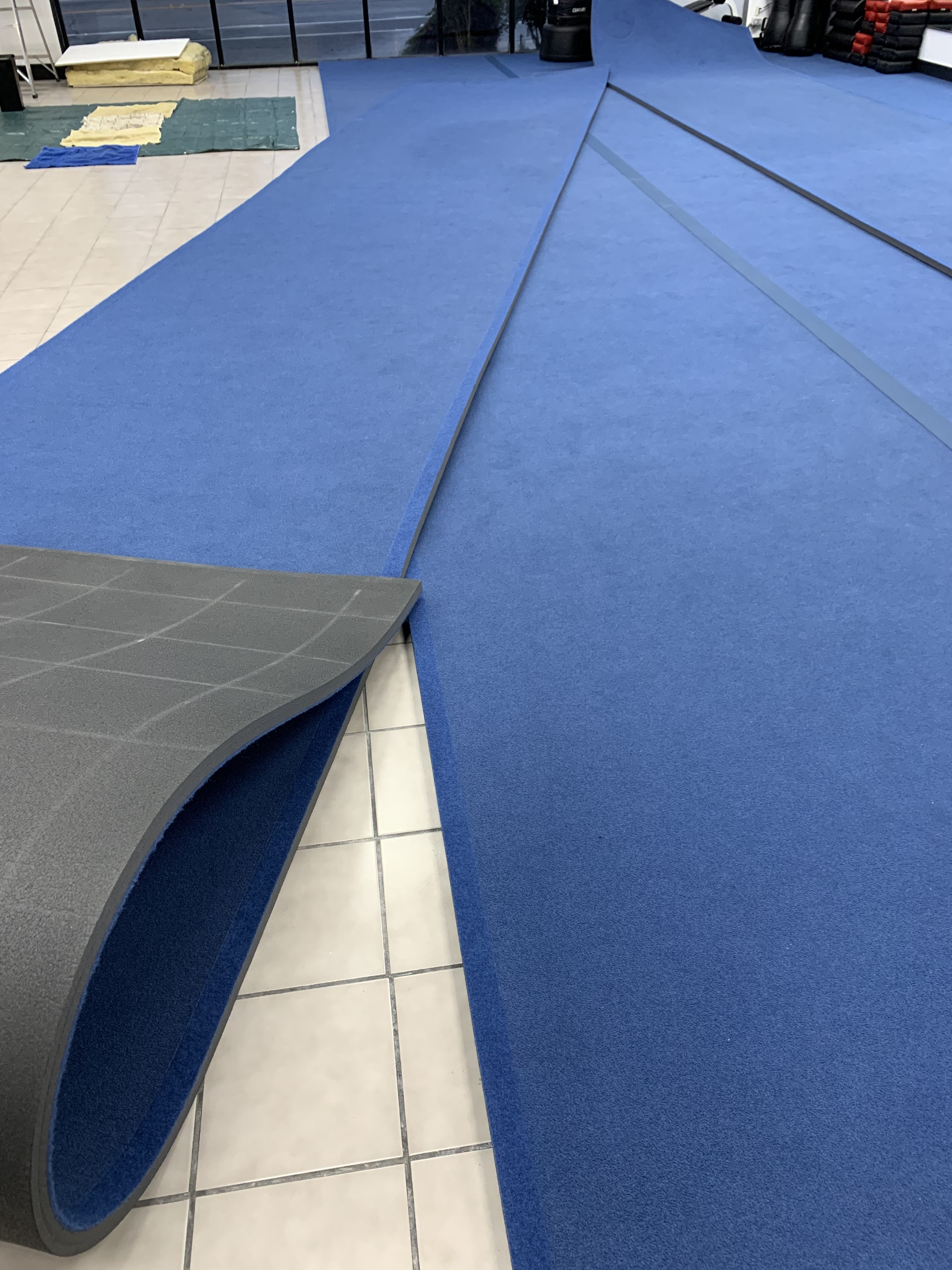

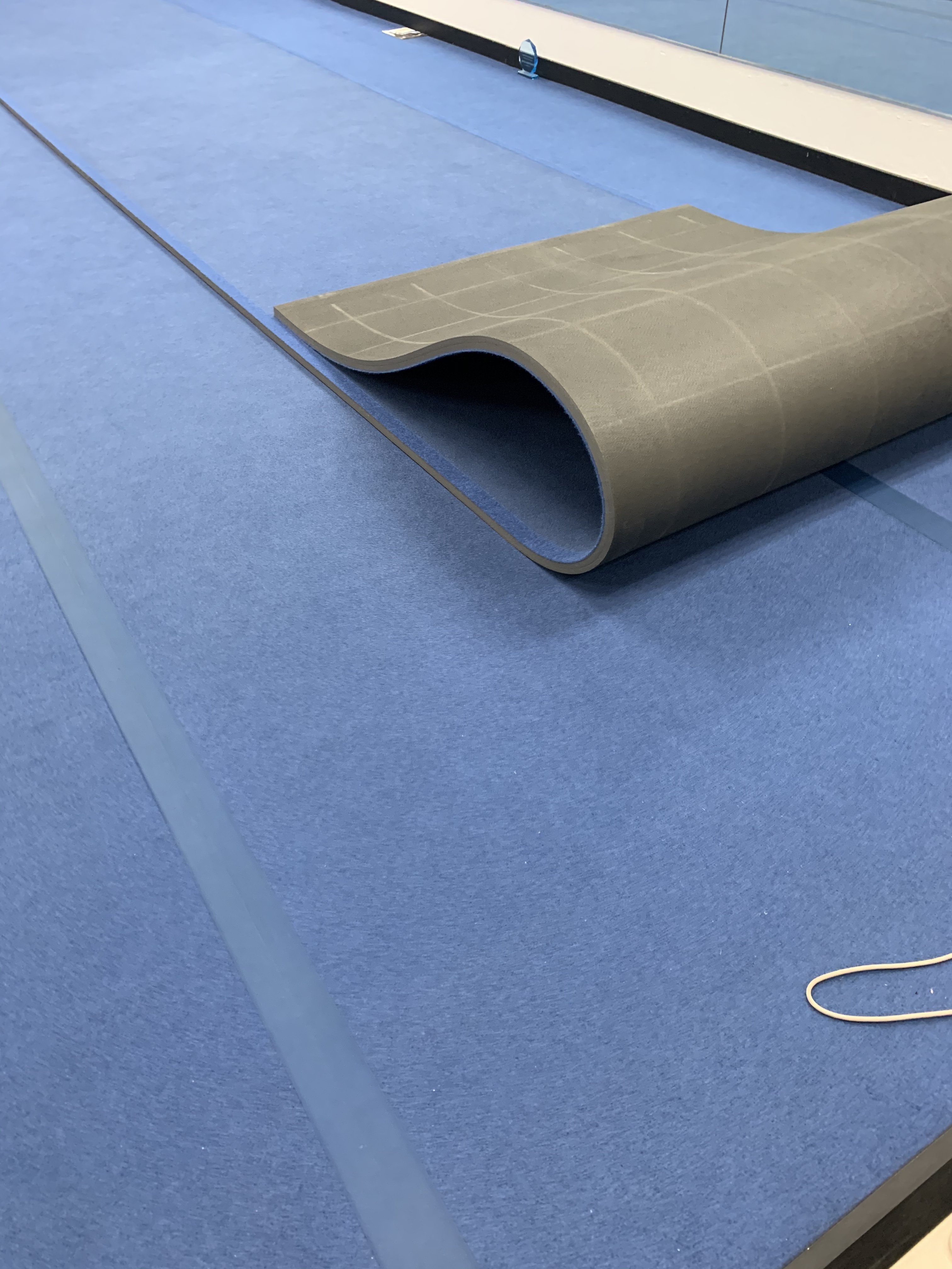

Guy at local karate studio wants these cleaned he had a small flood, and was hoping for
Low moisture cleaning.
Any suggestions how to best handle these
rubber back felt type top.
he said he uses a canned carpet cleaner foam type to maintain it.
So there’s residue possibility.

Just use your glided wand after you prespray with some sort of oxy additive
jmo

When we do those we rotovac, do a dry pass with wand, spray with benefect, set up fans then run brush pro to work in benefect and take wand marks out.

Take them out and powerwash both sides.
[/QUOT
I cleaned gymnastics mats same thing, carpet on top is olefin, cleaned with normal cleaner, scrubbed with cimex/brushes, post treated with benefect. Waste water was black, helped get the feet smell out...
Which Benefect do you use for this? "Decon 30" or "Atomic Degreaser" or "Impact Cleaner" or what?
