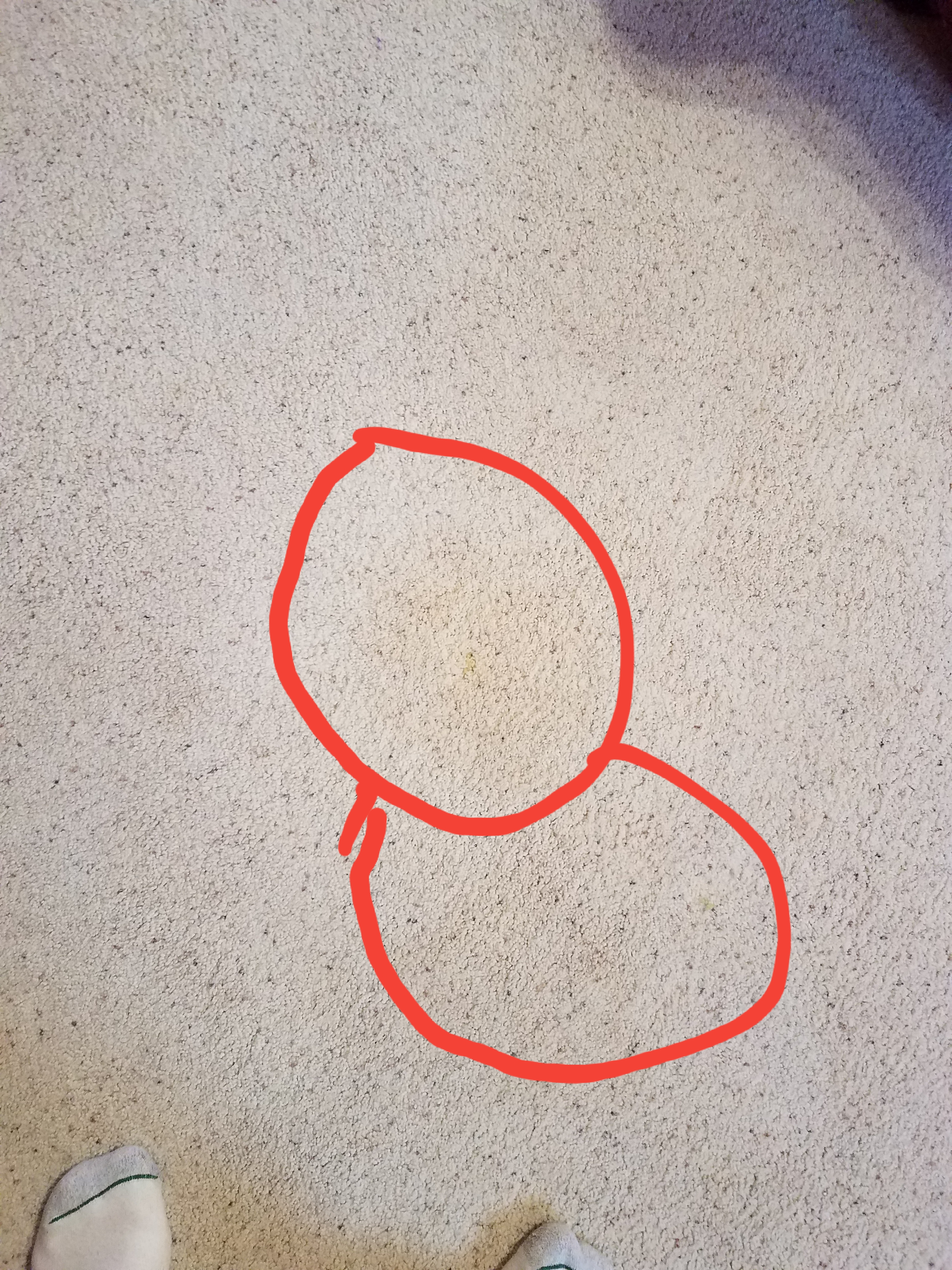

Customer called and needs chocolate stain removed. What's the best way to remove milk chocolate from white carpet? Not sure what the carpet is made of. I haven't seen it yet.

I don't think SS1 is an enzyme. I will check back tomorrow because I left some fans there over night. I may have made a mistake using flex ice as a rinse because my Pro's Choice spot guide says to not use an acid rinse on chocolate. Probably should have looked at that before and not after.

The spots wicked back along with a random spot. I should mention I did use my portable for this job at 300 psi. Prevac, tons of dry strokes, air movers left overnight, ceiling fans left on and bathroom exhaust fans left on. I'm thinking of using a encapsulation to correct this. Sorry my picture sucks!
