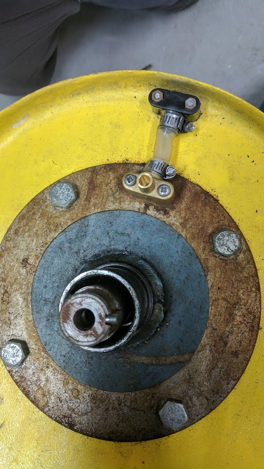

Hi All,
One of our Cimexes is flinging encap solution off of the round blue planet where the solution enters the unit. Solution is not going down through the pads properly. The hose seems to be okay. It enters a 90 degree thing then it spills out the little hose and is getting flung off the sides of the planet. We're attempting to take it all apart to see what is going on so we can make the repair. Not having much luck just yet. Any ideas?

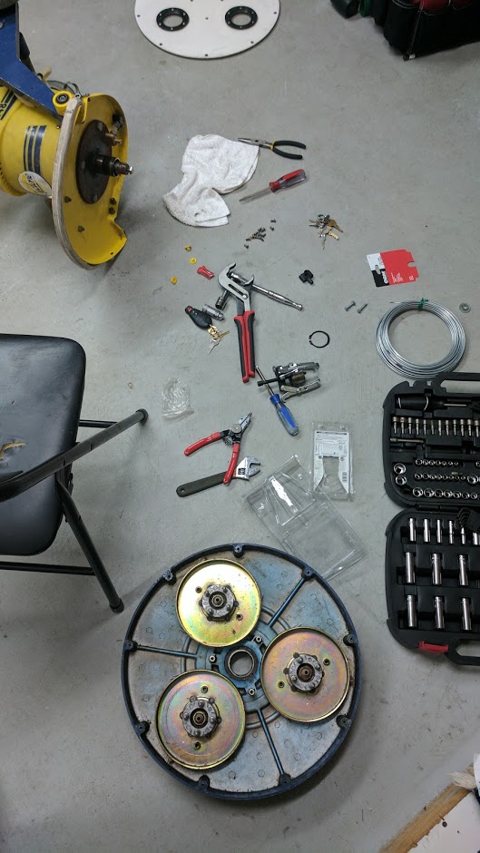

Thanks, all. Yeah, it's a 15 y.o. Cimex and it's never been done. Neither has my 18 y.o. Well, we've got it all apart. (Yikes!) Hope we can get it working again. But, some of these bolts were tough to get out and very awkward trying to get back in, LOL! Oh, we'll get it.

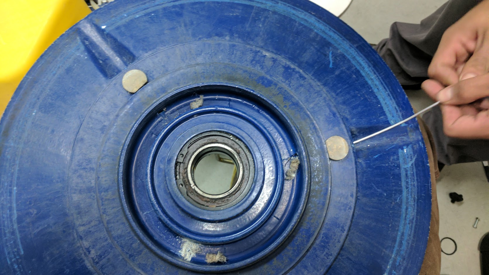

Thanks for posting that video Richard.
Steve, I'm sorry to hear that you took the Cimex apart to try to get to the blockage. Cleaning out the plumbing, as shown in the video, is all that's needed. The Cimex can be a bear to dissemble and put back together. If you want to call our office and talk to Rod (our resident equipment guru) he can probably walk you through the reassembly over the phone.

Rod called this afternoon and gave me good info. The auto parts store came through with the proper pulley remover and now I've got it all apart. Just need to reassemble. Hopefully the worst is over.
