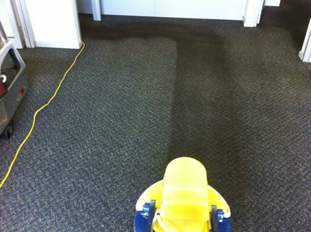

I don't own a Cimex, so I rented one today. Had a 6th floor office with halls that needed cleaned. I didn't want to drag all the hoses up 6 floors, so I Cimexed, using ProCaps "Later" encapsulating solution. Did a great job.
Question to you's that Cimex.....do you make just one pass with the solution on and then move over to the next path, or do you go back over the wet pass with solution off?
