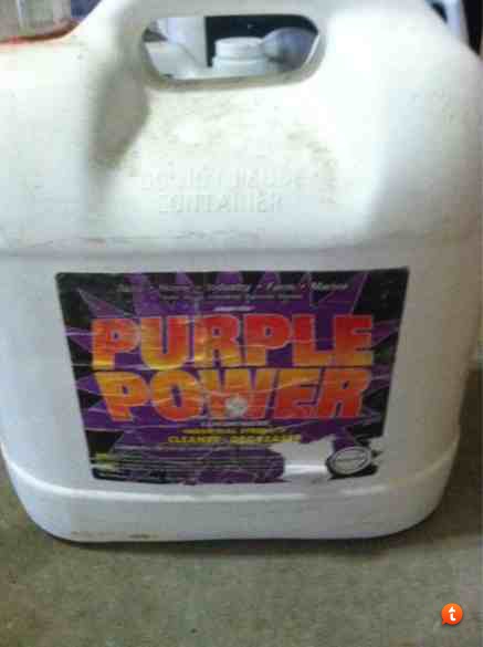

Walmart
Purple Power at 1/10 dilution.
I never tol ya that either!
Prolly ban me.

Oh mate. For a minute I thought somebody was going to use it on carpet.
