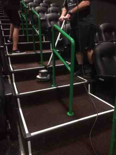

Orek is the only way to do the steps
This thing is awesome for steps
The stepsin was to light and a back breaker

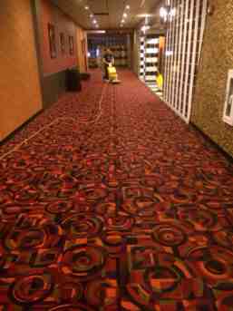

We did a theater yesterday too, we do it twice a year. 6-Cimex's, we start at 7:00 AM back by 11:00AM.
No steps like that, two long runways from top to bottom then a common entry to the theater. The main corridor to all theaters, concession area and a game room. We've done it for 5-years now so it goes pretty smooth, cleans up well.
6 cimex's at once :eekk: !
Daaayum.
We have 7-Cimexe's but the job really doesn't need a 7th operator.
A supervisor usually goes to get the started, once the 6-Cimexe's are filled and running he leaves the crews. We do take (10) 5-gallon water containers to give them a jump start, after that they get hot water out of the Butler in a box. Easy job, they prevacuum, it moves pretty fast.

We've done that dude 10-times and it still looks great each time. I was there in the summer when we cleaned it last and I had the Butler there for water anyway so I thought I'd give the concession area a good rinsing.
The tech's laughed at me and told me to put it away. I told them I was just going to rise some of the soil out, I cleaned head to head and while my area looked greatly improved it wasn't as bright (clean looking) as the Cimex'ed area. :eekk: They told me to put the unit up and go back to the office, they Cimex'ed over what I had HWE.
I had super hot water, a very strong precondition, agitation from the Cimex and still lost out to appearance from the Cimex.
I went back to the office with my tail between my legs.........at least I think that's a tail? :pig:

No option to stick the steps..well I guess if you wanted to stretch 15 sections of hose you could..
Then chasing down the drink spills that will pop up after a few days. No thanks we will encap them
The orek did awesome..I am ordering 2 more as well as a 19" cimex all that will cut us to about 4-5 hrs. That's some good coin at that rate.

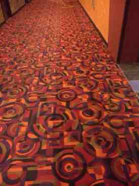

I just did a 10 cinema movie theatre but I used HWE on all of it. It was trashed. ive been trying to get the manager to use us monthly for encap but he isn't biting. I have a brush pro 20 no cimex here.
That was dirty. The only area we see like that is the concession area where they transition from tile to carpet. The rest looks decent and then as we clean the colors pop and the texture is revived.

the foyer area where it goes from tile to carpet was the worst. 8 hrs for less than 3,000 sq ft. sweep, spray, rinse, rinse, spray, rinse, rinse.
last cleaners used a portable and left a huge amount of residue that hardened up like concrete with the dirt it attracted.
