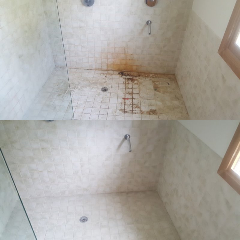

Can someone give me a rundown of what their system is for cleaning tile and grout in a shower? I would like to know psi, temp., prespray, rinse, sealer and anything else you can add to help me from messing up. I'm doing this on my own personal shower but would like to offer it later down the road. I have a mytee hand tool for cleaning tile and grout. Thanks!

We do lots and lots of showers. They can vary a lot but just the cleaning side isnt that complicated.
Usually we start with a high pH pre treat, most of the time no grout line scrubbing is needed because the chem does all the work. Stainless grout brush if you have some really tough areas.
1000psi, high heat (even though not always needed), cobra hand tool or hand spinner. Sometimes youll need razor blades for really nasty spots etc.
if the shower is kinda nasty many times youll need to replace the caulking with something, color rite makes nice products.

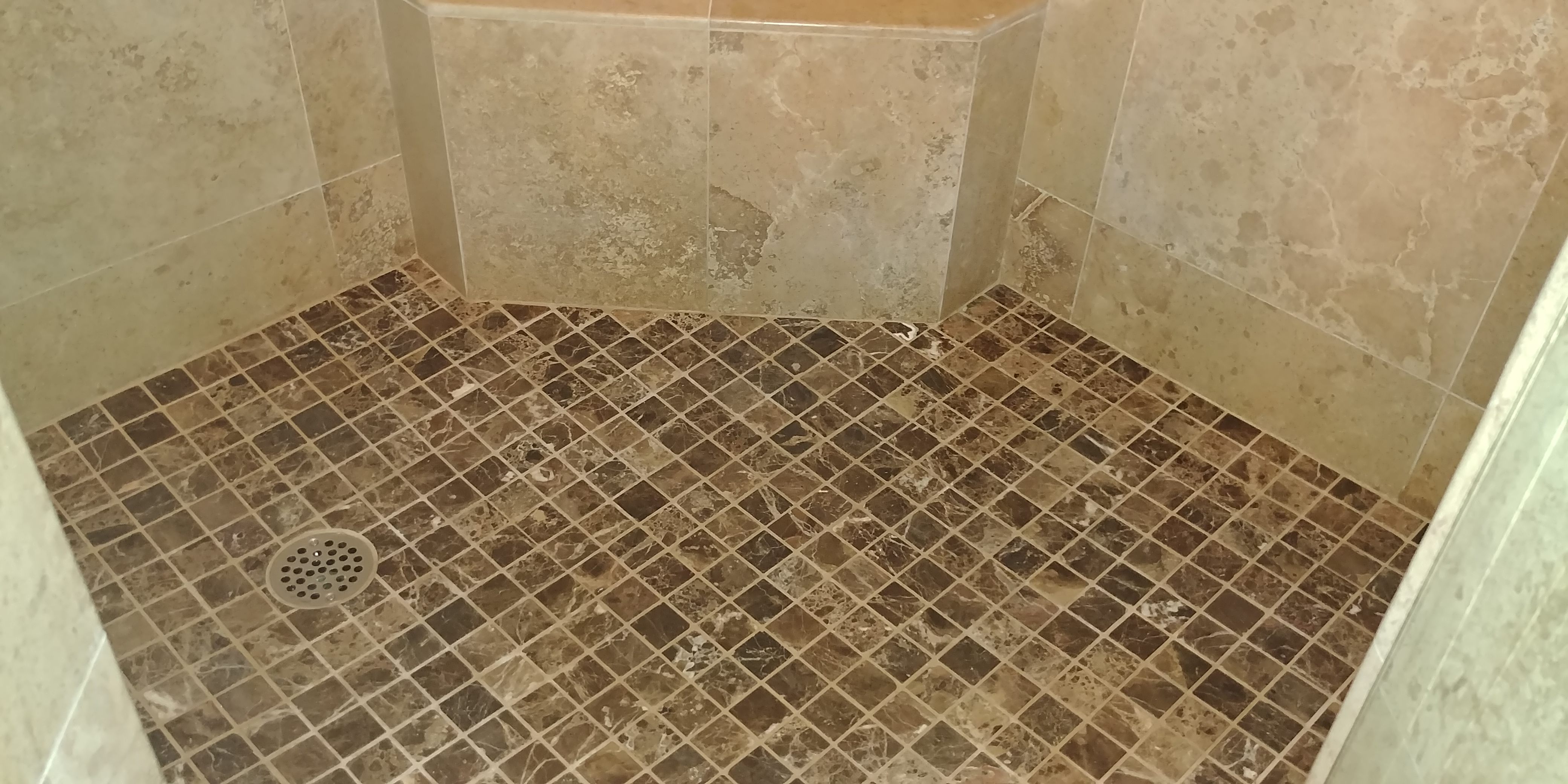

I do a lot of new construction post cleanings and seal. Color sealing walls and even pans are awesome and permanent. I guarantee my jobs. If however the grout is impregnated with scum, scale, mold or previous penetrators I won't guarantee.
It's the level of cleaning that can ensure a good long lasting bond for any color sealer. I use a chemically and mechanically bonding sealer and I never have to apologize for failures. I've R&R'd a lot of shower pans and then color seal after grout cured a few days. Those jobs I warranty as well
