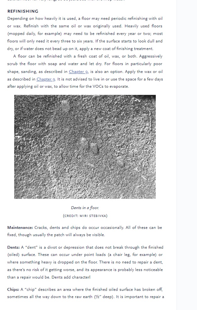

so it looks like
scrub with soap/water (maybe a little dlime)
re-oil (?) and let cure
sand with green pad or 80-120 grit sandpaper
Apply new wax coat
buff with a white pad
*I'd be curious if the "sand it down smooth" is to correct problems that are better corrected by other methods or even a complete redo or just to give a more polished texture
