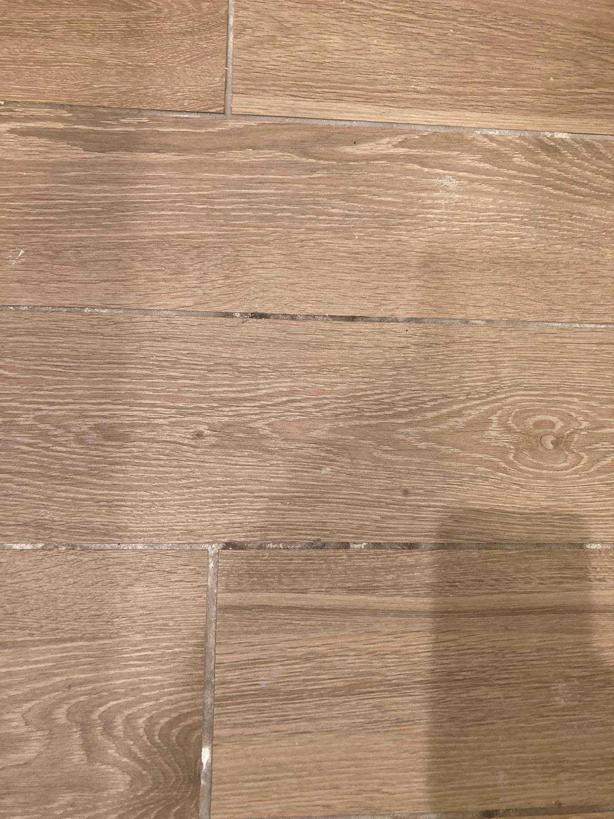

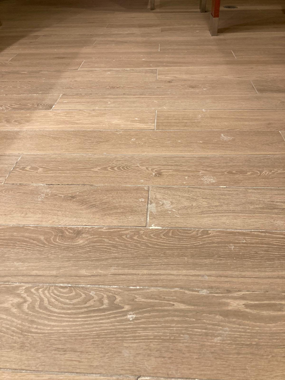

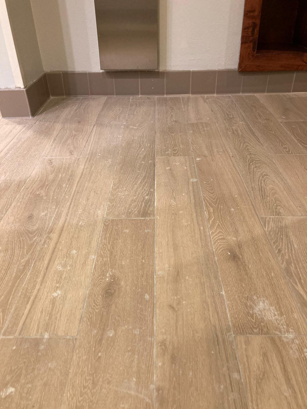

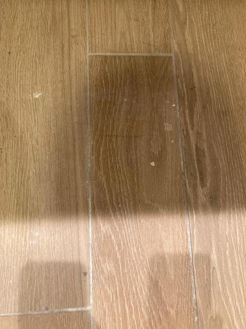

Here's a challenging one I have to go inspect this week. new install in a Marriott, epoxy grout & porcelain plank splattered in construction gunk- paint, drywall mud, food etc... Most likely I will NOT be able to use my truckmount due to logistics..
175 and hopefully a garden hose rinse to a floor drain.
Thoughts?

A crb, battery sprayer and my little Clarke machine would handle that. But you think it’s stupid. So I’m no help. Good luck, Chuck.
13,371
Have fun and charge a lot.
Scrapers razors lacquer thinner and steel wool to start.
If you can't use a floor tool which would help sooo much even a porty woukd help you will need to mop it good to prevent all the splotchyness that will happen when it dries. A flat mop might work but you can't scrub as good with it. Get a 32 oz mop head if you can a 24 is ok but will be more work.
You will be on your hands and knees a lot so maybe knee pads and watch your wrists. They will hurt the next day.
That's my approach anyway.
