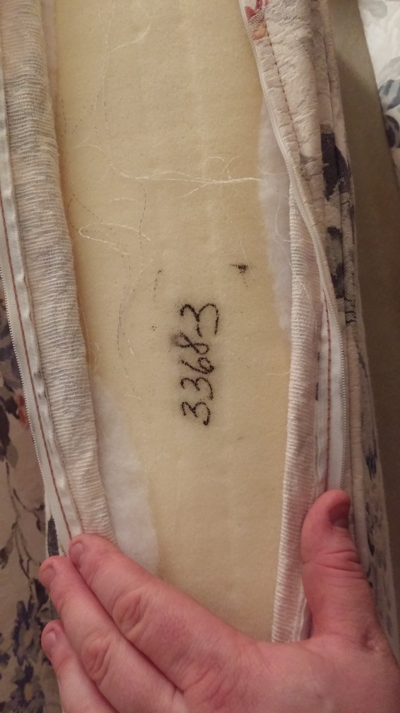

Scott
Acid rinses dont cause browning and help most when cleaning natural fibers. Cleaned this the other night with the upholstery pro. No bleeding, but was using a the upholstery pro and i controlled the water to exactly what i needed to clean the fabric.
This is am after picture.
