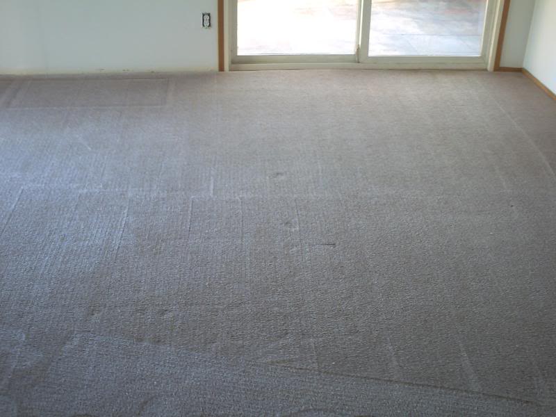

Ron Werner
8,726
Ron Werner
No saw tooth marks, but still looks cleaned
This was with a hybrid glide. If you had no glide or were using a holed glide,, would look more even

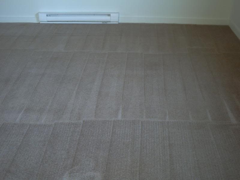

'zaccally
as long as the wand strokes are all square, straight and even to the room, they don't look bad at all .
It's when they're all bumblefcked haphazard pattern they look like crAp
