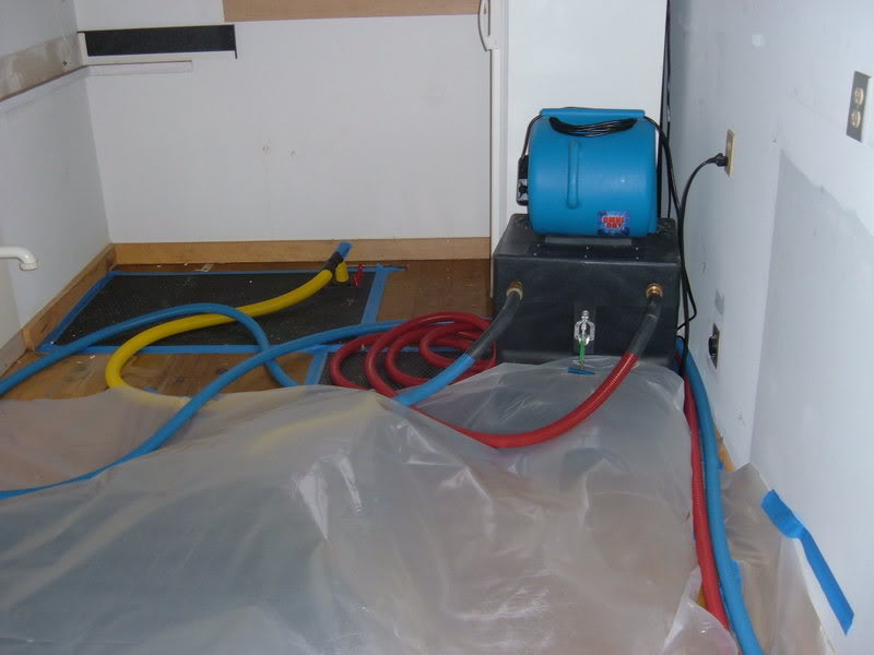

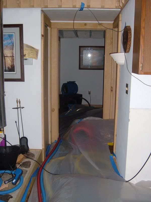

what happen is the condo upstairs flooded the guy down stairs was out of town so
the the wood floor was wet for a week before we got to it.We are trying a vapor barrier with dehus blowing
into the barrier we don't have a desiccants at least not yet.Thanks for the input guys

Do this with your injecti-dry panels and dehus.
If you don't have panels, then just tear it up.
Again, how deep did the moisture penetrate? If it is down to the concrete then don't bother drying.
