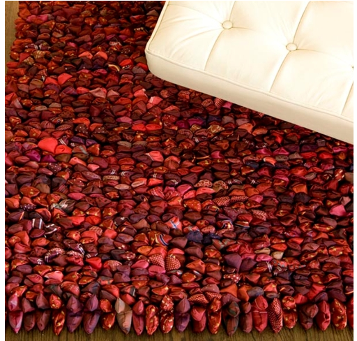

Haven't seen a rug we were afraid to run through the wringer, as it puts no shear stress on a rug. We've not only washed and wrung the felt shags, but have washed and wrung several rugs made out of silk neckties. Came out great.
The beauty of the Rollerjet, the best cleaning machine ever made.

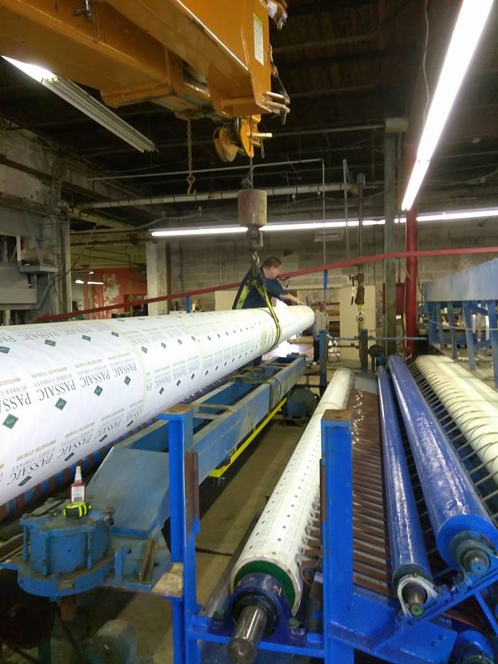

As Tom mentioned, with any mechanical device there's a little maintenance required. Ours uses air for pressure, and we rebuilt the air cylinders once. Recoated or replaced the rollers three times. Chains need tightening and chains, sprockets and bearing need replacment eventually.

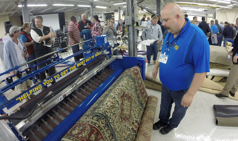

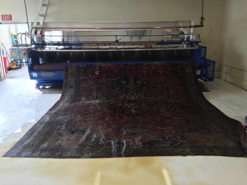

What we are looking at here is a 16 foot basic Rinse Wringer. We make 13', 16', and 19'. The bells and whistles create the cost. A 13' Rinse Wringer starts at $125K and the other machines that are bigger with more add-ons like Hagopian's can exceed $250K.
Note: Above unit was made and delivered last year.

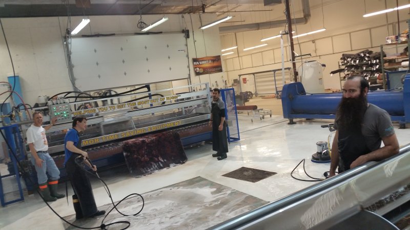

This is the most current MOR with a linear motion jet spray. This 16' machine is a wash wringer at Joe Gabel's

Joe's one is a sweet setup... I'm still in awwwe of Roberto's wringer... That was 35seconds to run it back through in reverse...
Time saver is an understatement...! I understand now how fast and efficient a wringer is...
I'm going to protest at work until I get one...!
