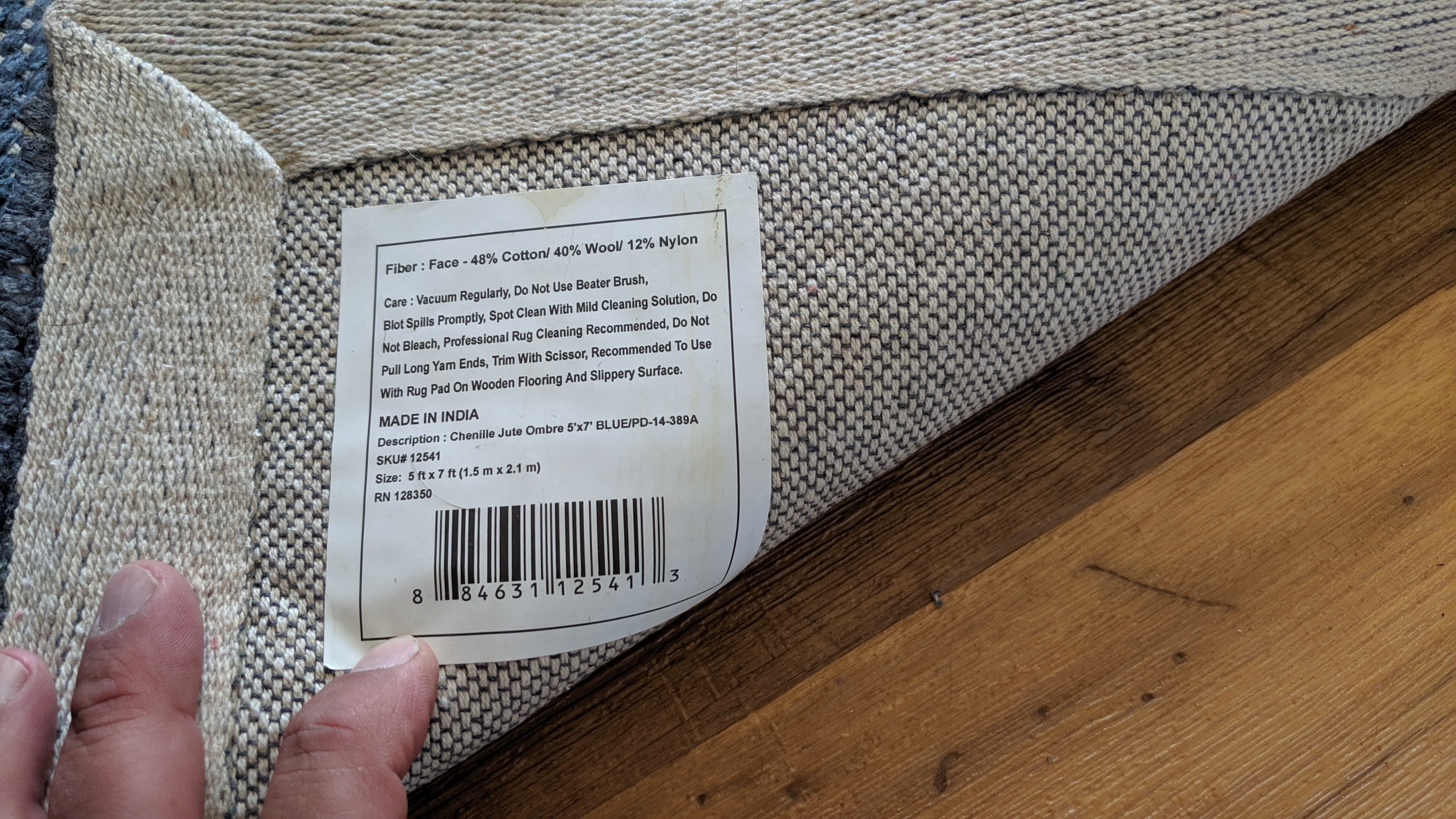

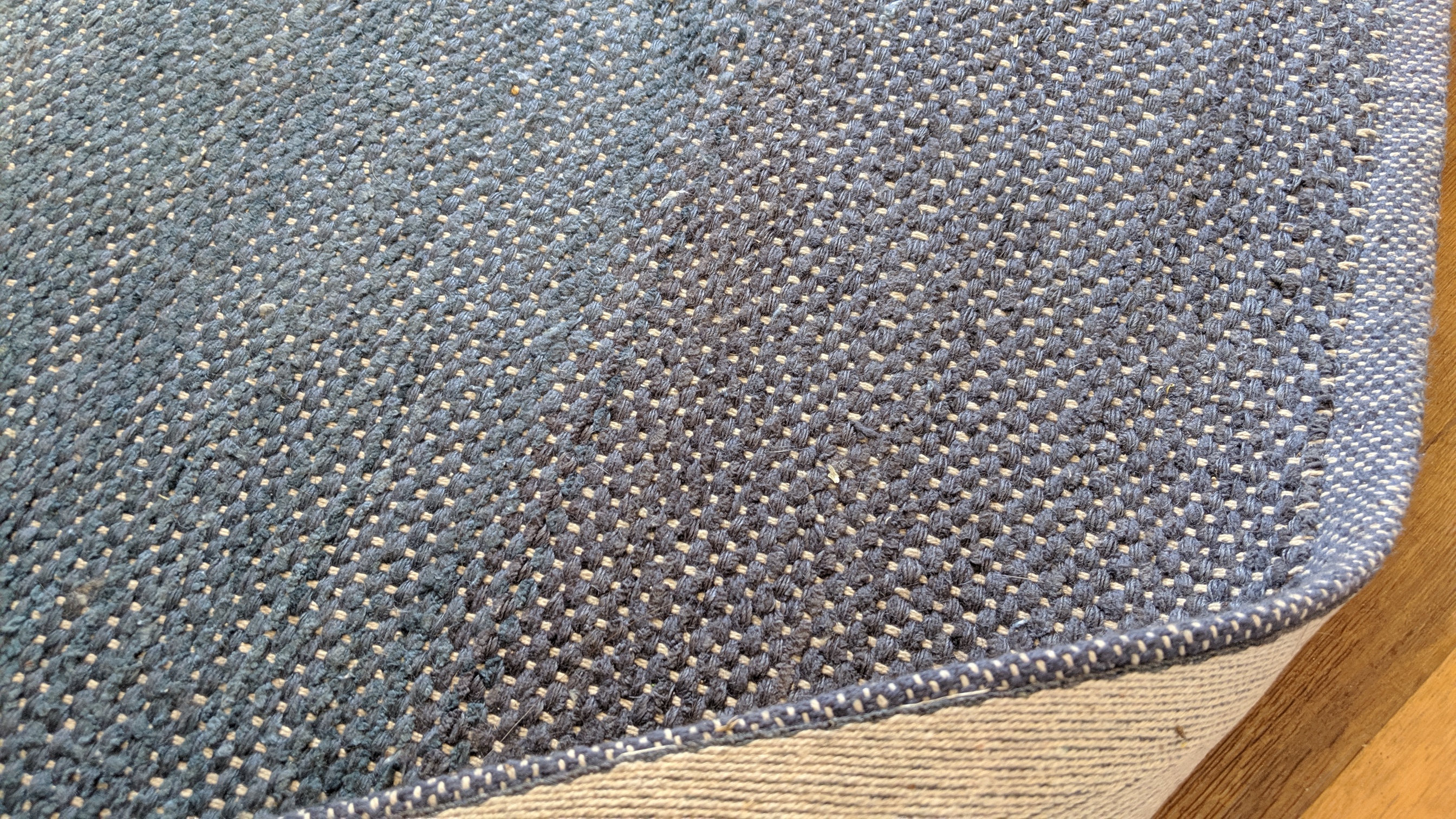

If you just look at that edge tape wrong, it will delam....
I HATE rugs like those. People ask me to clean them when they are full of urine, I simply say, yes, I can clean them, but I’m expecting them to fall apart....
They look at me puzzled, I flip the corner up, grab a piece of the tape, and gently pull, and yup, it comes off as easy as scotch tape off the roll...
Junk.
