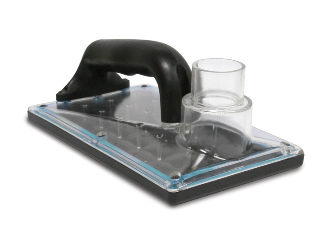

what's an SOS tool?
that reminds me, I have medium size Water Claw you can have when you grab the rotary in June

Wow thank you Larry! I'm stoked to come down there. The SOS is a small inexpensive subsurface extraction tool.
