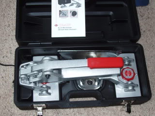

and I finally got a 10-128 Mini Pattern stretcher. $300

Please explain the difference between these two mini stretchers
Roberts Pattern Matching & Seam Repair Stretcher
Roberts Locking Dual Head Mini Stretcher

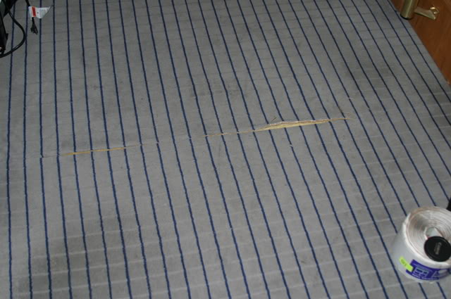

Well, I did that commercial seam on an axminster yesterday. In the main foyer area on the fourth floor.
I uplifted the join and then removed the existing tape. I used DS KG tape, ran a heavy bead of KG hot melt glue down the middle of the seam, pulled it together and then activated the KG tape either side of the stretcher, allowed it to cool then removed the stretcher, moved along and repeated the procedure.

Notice the curling on the RHS. The ladies I was talking to were sick of it grabbing on their heels and tripping them up.

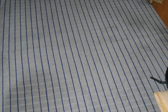

Done.

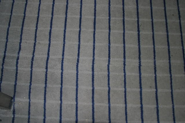

Close up of the curled area. It was missing about 2-3 rows so I trimmed up best I could and then seamed.

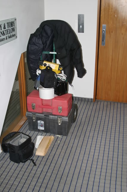

My make shift tool carrier to get everything on the first trip so I didn't have to leave tools unattended.
Overall pretty happy with how this one turned out as a first attempt.

John when It is a little skewed like that , what I do is crank the pattern stretcher to make it line up. Than it does not matter wher I spot weld it with the Kool glide . Than start you seaming as usual spot welding is just to hold it in place with out nails or tacks. I am going to have to get some messed up carpet to show photos and when I do . I will post it. Looks good John.
