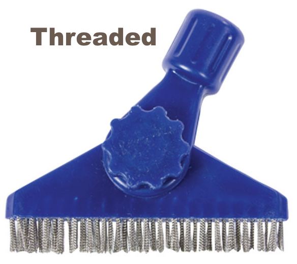

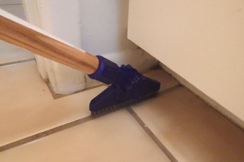

Stainless brushes also help.
http://www.cobbcarpet.com/zen/index.php?main_page=product_info&cPath=69&products_id=5460

Hand and stick brushes and little wire brushes do come in awfully handy.

I have one of those little stainless steel brushes and wonder why they are $30? Is there somewhere else one could buy one without feeling ripped off? I paid $25 at interlink and thought that was way too much.
Larry Cobb
5,795
Dallas, Texas USA
Larry Cobb
Jimmy;
The original SS brushes were 5".
The new ones are 8" long, which does save some time when scrubbing.
Professionals use the best tool for the job.
