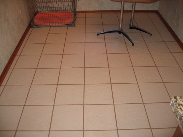

I did this one yesterday. The customer said the floor was dirty and spotty. I just thought she meant the floor was dirty. I sold her on the color seal. We cleaned it good and it came out great, then set fans, went to eat lunch, came back and sealed it. There is always a haze so we mist some water or neutral cleaner, scrub with a red pad, and then use cotton bonnets to pick up haze. After buffing I noticed the floor looked off. There appeared to be a wax on the tile that has worn off over time. The customer said it was like this before we came out. I really don't see anything else we can do but apply some finish to the tile. I told her that may be the only solution and down the road she would need to have it stripped and the color seal re-done. I need some advice on this!

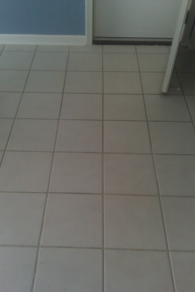

Here is the before. Do you notice any shiny spots on the floor? I just see dirty grout.

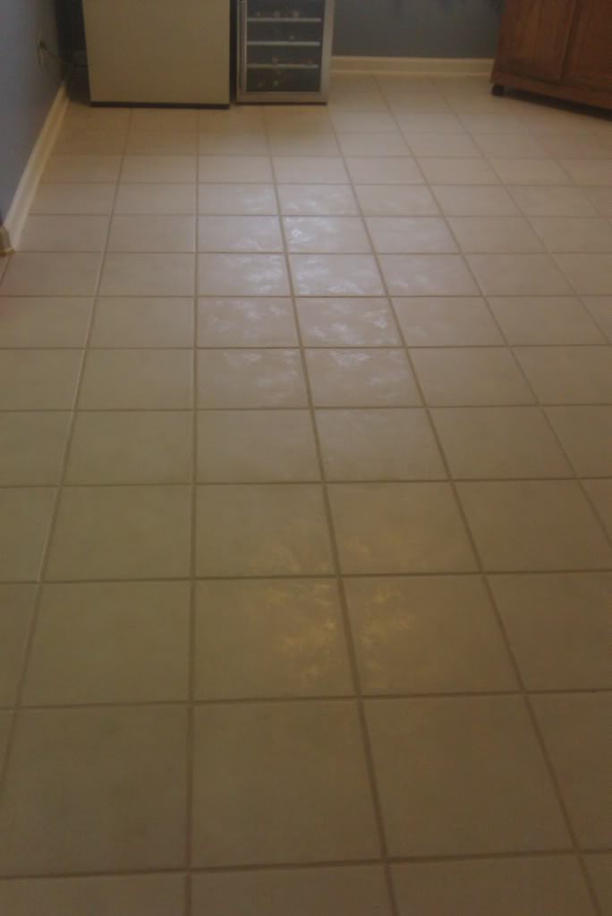

Here is an after shot. Notice the shiny spots all over the place.
Another after

I've run into a couple that looked like that. Each time, it was leftover finish that someone shouldn't have put on. It can be a nightmare getting the shiny spots off. Finding the right stripper is key.
okkkk wait a sec....did you see the blotchy shiny spots BEFORE you color sealed it????
if so then.....and i know i bust your balls at times...but ..........
YOUR DUMB ASS SHOULD HAVE STOPPED RIGHT THEN....AND EITHER TRY SOMETHING NEW/DIFFERENT TO FIX IT ORFOOKING WALKED!!!!!!!!!!!
so now, you charged her what ever to COLOR SEAL (so i imagine its pricey) and didnt fix her problem...
AND NOW YOU MADE IT WORSE!!!!!!
and you have the balls to tell her to bad maybe next time pay some extra $$$$$ to fix it....
cuz color seal aint just like using a sharpy to touch it up.....
shhheeeeeeshhhhh i knew something like this was going to come up and bite you in the ass

Geez Daniel, what a bunch excellent advice from some of these tools on the board. Anyways, check out photo number 2. From the angle you have, it shows roughly two squares by five squares of actual shiny tile (top ten). On the right column, compare the second tile with the third. The third you just have to rotate to the right 90 degrees. Also the two bottom ones are the same. My opinion, it's the tile.

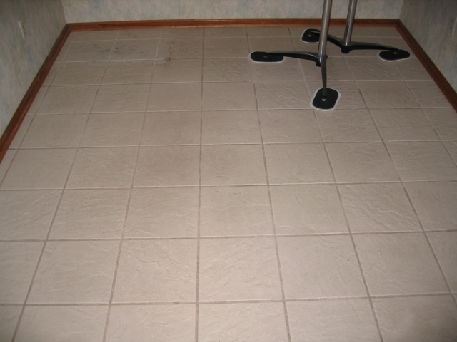

Yes agreed and Doug I didn't see any problems with wax residue or shinny spots. The customer said it was there before I cleaned the floor but I didn't notice it maybe cuz the floor was dirty. I inspected everything real good, measured, and checked the grout for wax or sealers and there was no wax in the grout. I guess it's a problem or defect in the tile.
Anyways should I just tell her that's the way it's going to be or would you put finish on it?
I told her I did not recommend applying finish to a floor that has been color sealed.

This type of tile has both matte and shiny portions to it.
Your real issues lie in the fact that there is color seal residue left in the lower parts of the tiles. Go in there with a box of Magic Erasers (the extra power ones) and you will solve your problem.

your first picture is taken in a shadow so you cant see anything. your other pictures are taken with the light reflecting so you can actually see the issue.

Ive cleaned this type of tile before the shine is meant to be there. did you try removing one of the shine spots? Did you guy back and inspect the troubled areas. they look uniform to me. If its not uniform its mop'n'blow and you will be re-colorsealing those areas after you try to remove that crap. Try some goo gone professional on a rag without touching the colorsealed grout you may still be able to be a hero.
Sep 7, 2008
3,797
I called and offered to attempt to remove the shinny spots by hand, but the customer said she is fine with the floor. I explained that I thought I could get them out but there would be a modest additional charge to do so and she said she was happy with the floor. I told her if she changed her mind to call me.

The random "shiney areas" are just characteristics of this tile from the factory. You can't change them. If you had tested ONE tile you would have confirmed this.

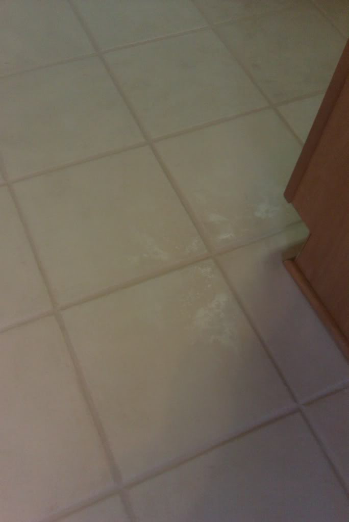

I think Danbrowns looking at the last photo were it appears to have color seal on the tile, the large middle pic with lots of shiny spots he sugeesting its 2 different thinks
a pattern thats there already and some tiles near the wall with a little excess color seal.

Here is an example where we had used Jamocha on a light colored floor. The only thing that would remove the residue leftover was a one jet tool at 1kpsi. The cimex and scrubbing had no effect on it. This tile just liked to hold on to the haze.
This haze was from a dark color sealer. Now imagine what it would look like if the color sealer was a close match to the tile color like yours....
After spending hours with the raptor tool we were wrapping up and I was still unsatisfied. It just so happened that I had a magic eraser in my kit and decided to try that instead of breaking everything out again. It worked fast and completely, and erasers have been a stocked part of my arsenal ever since. I took these photos over 5 years ago.
