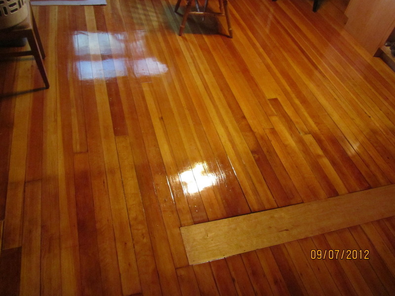

I’m really happy with the house even though it is a ton of work. 5bd, 2 bath / 2000 sq ft of finished space + 600 sqft shop on 7 Acers for 129,500 is a hell of a deal around here. I’m post some more photos on a new thread later. Here is one of the Dining room floor I refinished:

what did they do, tale out a wall where that patch is and cover it with carpet or vinyl??

Yes Larry, The house was built in stages. The Dnrm / kitchen was the original house with basement. They doubled the size adding on what is now two downstairs bedrooms and bathroom then added a second floor. The Front Lvrm and back porch were added in the 50’s. The Kitchen Floor is rough because of past water damage. The Dnrm / Kitchen has Tongue and Grove woodwork on the walls and ceiling and kind of has a log cabin vibe. We just installed an island with a stainless counter top to brighten the room up. We patched in some of the other sections of wall but left that plank thinking I could put in some kind of inlay down the road.

I like to use the old school oil based gloss with the amber hue. I don’t even stain the wood. Oil based is twice the solids and half the price of water based. It’s a natural urethane and very easy to work with unlike other oil based products that you have to stir every minute or it will look like crap. Once you go to Simi gloss, satin or other colors oil based products become much harder to work with
