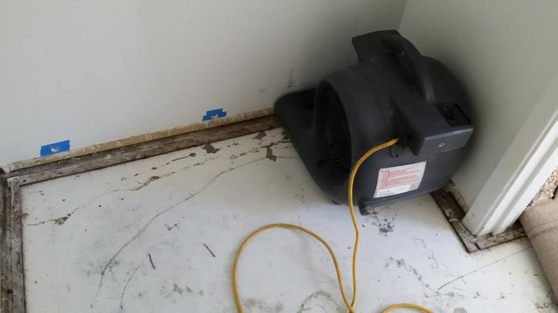

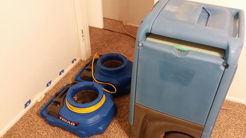

I've been on this job since tuesday. Upstairs apartment had water heater leak that soaked downstairs.
The wetspots are starting to shrink but i'm running into problems with a few walls. So, thought it might be a good idea to drill some holes.

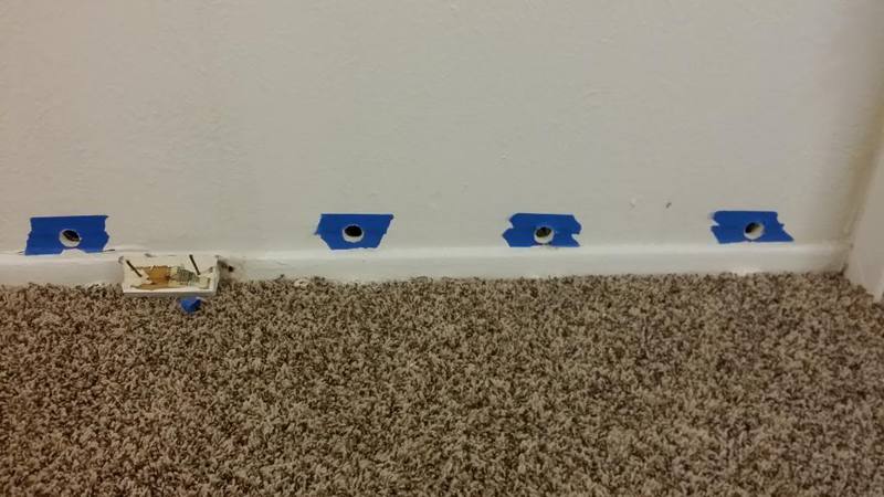

did test drill in a closet by removing the base trim and put a 1/2" hole. Unfortunately, i ran smack into the 2x4 sill plate. so, I drilled above the base trim on the rest of them. I put a couple of 1/2" holes in each wet cavity. Is that bad?
here's todays pics.
Thanks!

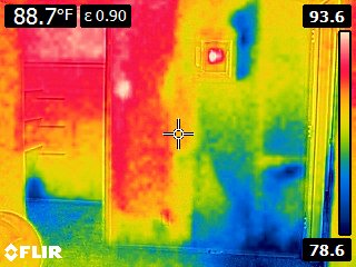

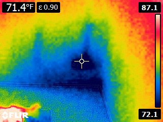

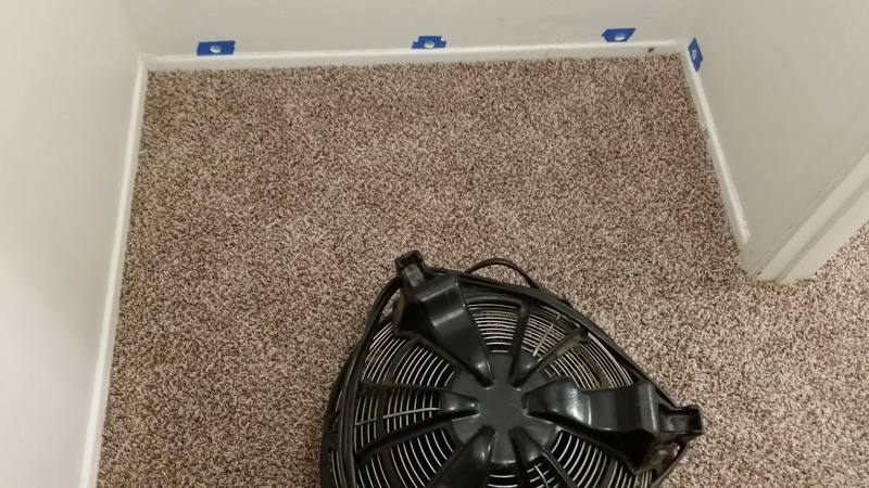

All the walls are interior without insulation with the exception of this outside wall with insulation (here's the flir pic and the following jpg shows the two holes i drilled)

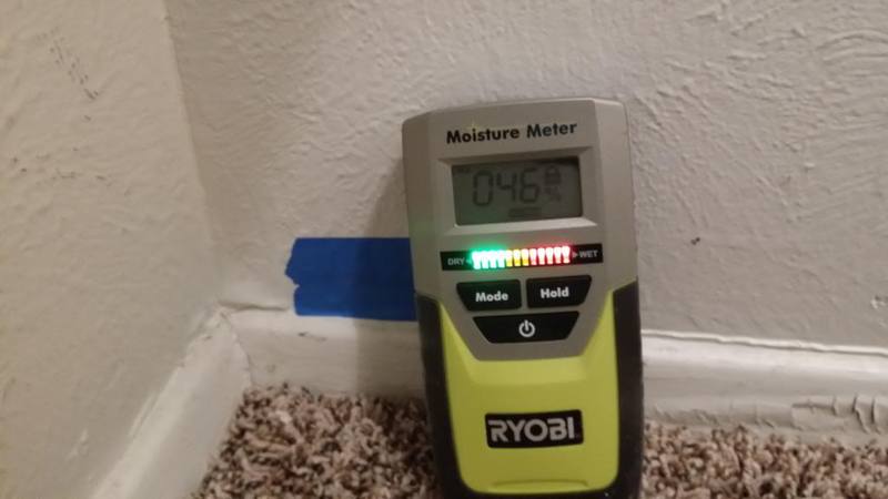

The trouble spots are still maxing out my meter
Am i doing this right? What advise can you give me?

Couple things, in the pic with your meter, it seems there is a coat of plaster type material, so you have more material to dry.
It looks like your surface temp in the thermal cam is 88 degrees in some areas and 71 degrees in the other wet areas.
With the holes, I bet you are going to make a huge difference in drying just with the warm air exchanging in there.
Now, matching the surface again plugging the holes is going to take some talent.

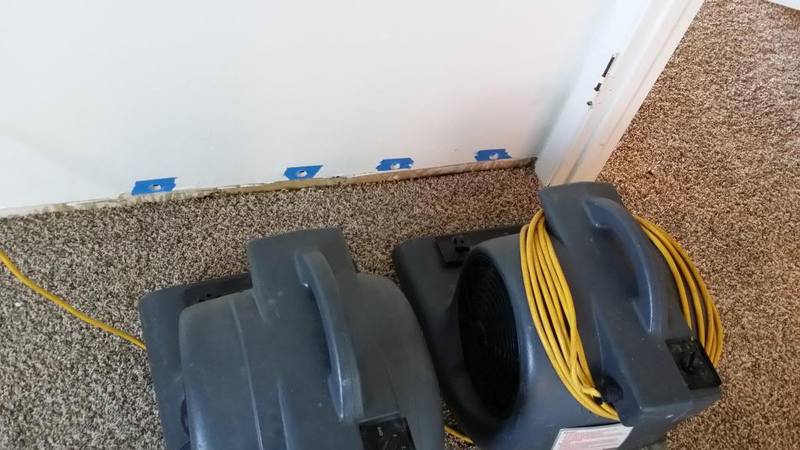

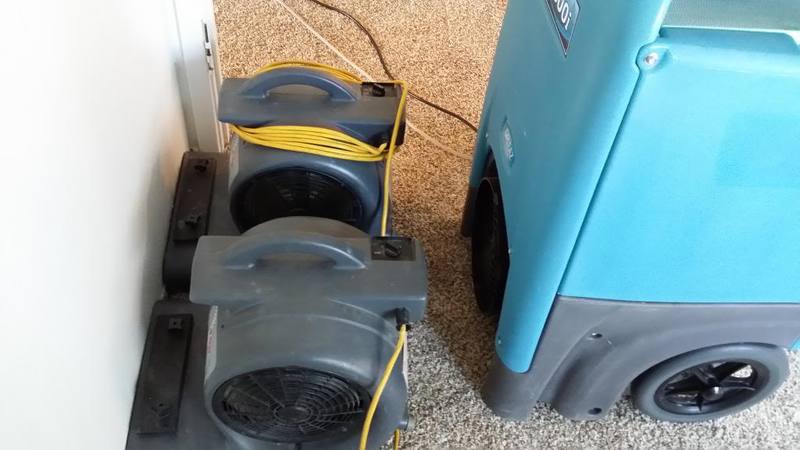

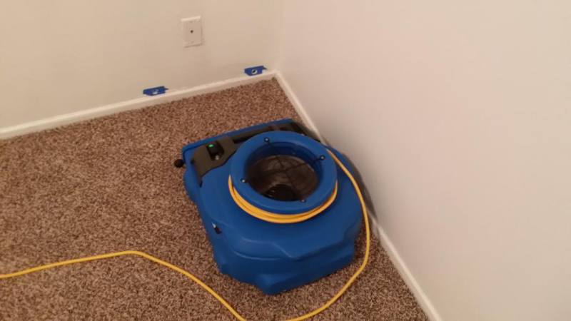

Can those types of airmovers take static back pressure? If you are drying as shown you're not getting enough air into the air cavity. I'd move those machines as close to the openings as possible. Or switch back to standard whistle blowers if those units can't take the back pressure.
A probe type meter is really needed when wall drying exterior walls, with a probe you can get an actual reading of the wet or dry materials in the cavity. When we would use the thermal and non destructive as you are using to track down trouble spots, an intrusive meter is really needed to tell definitively.
I'm not convinced by the pictures that it is wet in the cavity (but it maybe), cold air could be causing you the temperature color differences. ???
1/2 is fairly large, in the future you might try a 1/4 paddle bit. It won't be as hard to patch when they turn the sill plate on it's side. Very rare to find that but you will find it occasionally.
We like the good old Drieaz turbo vents, you get much more air flow in the cavity so they dry much faster. But when we have large projects we are forced to dry without them in some areas. You can still do it as you have it setup, it just takes longer.

It does look like plaster in the pic but it feels like multiple coats of latex paint.

The flir image looks like the water wicked up since day 1.

I'm surprised how fast the walls dried by just drilling holes. The problem walls were completely dry 1 day after drilling them. Insulation felt completely dry to the touch too. I'll post some pics and yesterdays humidity report time permitting.

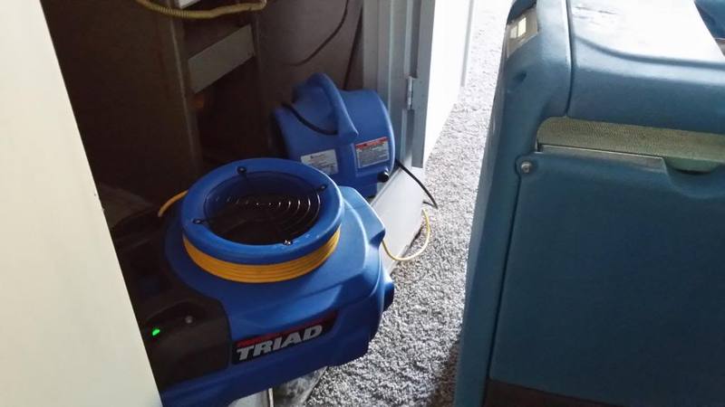

I am still having problems with both chambers inside the water heater/furnace closets. The particle board the water heaters/furnace sit on is still wet and reading 40% moisture content. I'm hesitant to drill because not sure how to restore the wood to pre-loss condition after putting holes. To do so would require removing the water heaters and furnaces and putting down new wood? please advice .

If everthing else is dry, reduce the chamber size of course, and maybe just make that a chamber in itself. You have to get heated air blowing on that wood, but you still might not be able to save it.
Also, is the water heater electric or gas? I am hoping for electric so do not have to worry about gas pilot light.
If there is anyway of keeping the heat to the wet with a canopy (plastic) or some nature to vent the dehu into, would be great.

I create smaller chambers whenever I can like mark is saying.
An etes or ELE would clear that sucker up in a hurry.

i checked on the job today and the moisture content in the water heater plywood dropped from 40% down to 20ish overnight. a couple of the corners are still reading high but hopefully i'll be close to goal of 11% soon.
