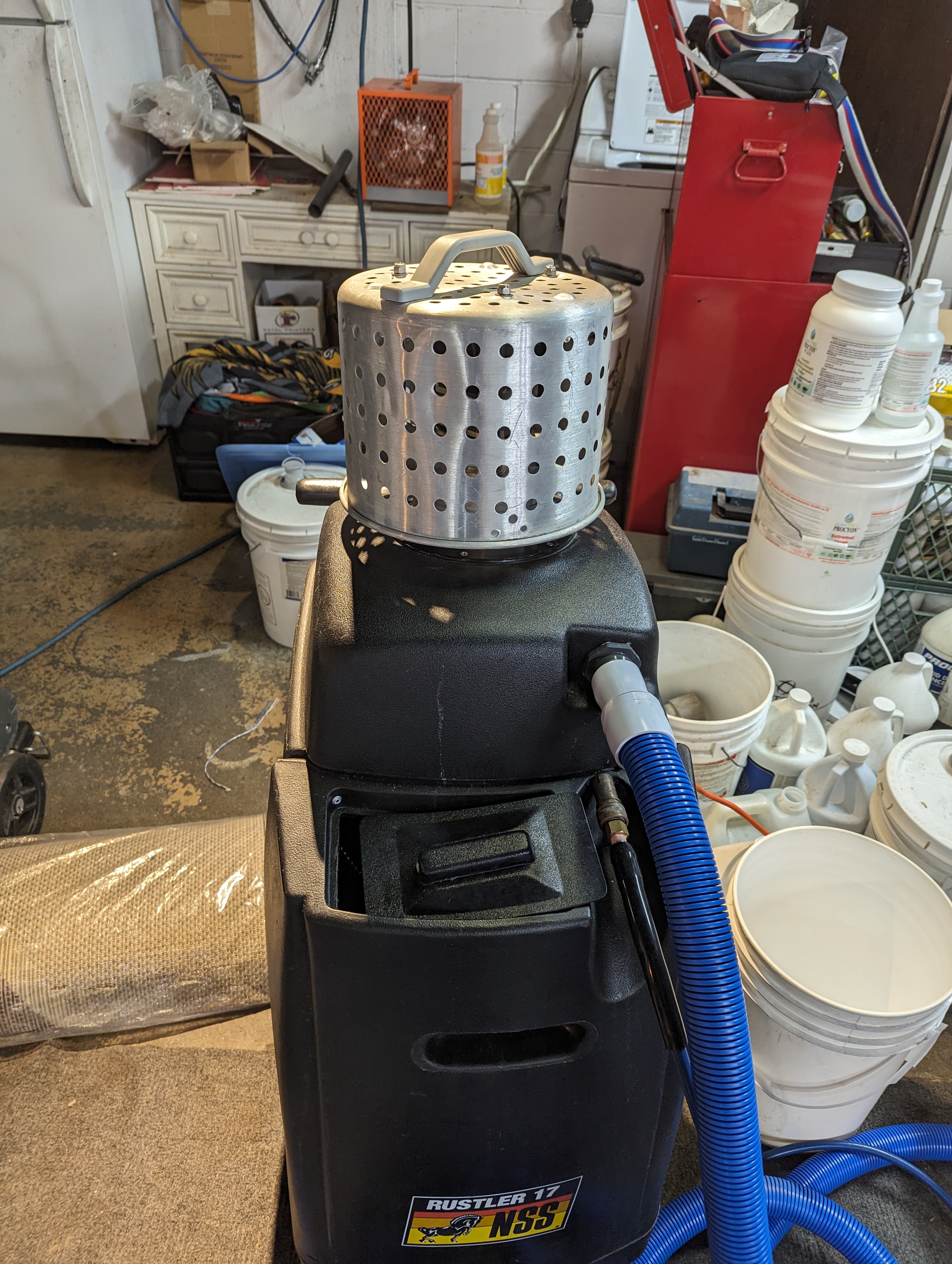

Here is a pic of the Steambrite booster on top of one of my machines. You need to make sure you have the right size deck lid. I believe it's 6 inches. Adds a ton of vacuum making it easy to do a multilevel townhouse or house just adding extra hose. No, you can't leave it in your truck and pretend it's a truck mount. Switching out the hose Barb will let you add 2 inch hose and maximize the vacuum potential.
