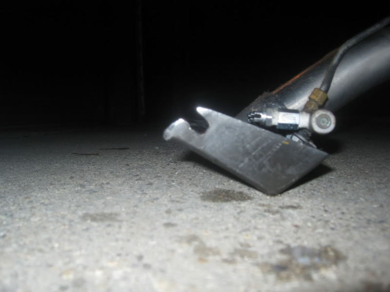

anyway, it's a semi circle notch you cut into the wand wing.
I used the glide to scribe the profile, then a dremel to cut a "V" and finish the rounded profile w/4" angle grinder and edge cutting fiber wheel
it allows the glide to slide off the end
If I take pics tomorrow, I'll show in detail what needs to be done.
Cause there's also a 1/8" of inside wand lip on the very end that needs tapered .
Other wise, it can shave teflon when sliding the glide on.
It's no biggie and piece of cake to do with a hacksaw and 4" angle grinder.
Minimal skill, some caution and attention to detail is all that's required for a good fit

Money no issue I would go with the TI and a slot glide.. I have a hybrid(factory 2nd) also but it doesn't seem to fit right, I think I'm going to boil the hell out of it then c clamp it to my wand and see if it fits better. I had a nasty today on 47th and crackhead(I thought I might die today) so excuse the nasty looking wand but here is the notch.

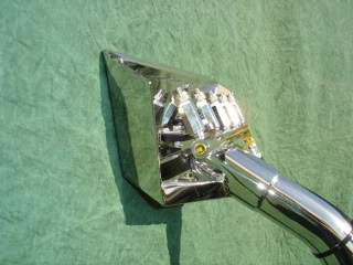

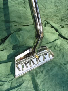

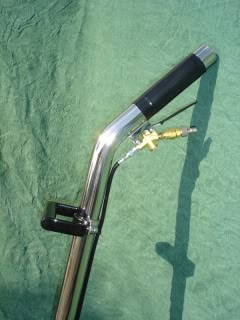

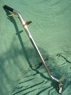

It's already been copied...just not very well, and the devil is in the details...like all things Green.
Here ya go, sans glide for clarity:

That is the exact same wand I have on the other truck except it has 4 jets
30,635
yep
cause it's a pimped CMP wand
If you like your POS BlueLine wand (a CMP) I'd expect you'll love a GH
a big baller like you though can afford a Ti
so demo both

your kidding right?
cut the metal solution line off, insert a rubber hose in it's place......replace the manifold with a shiny 5 jetter....and as Emerald Lacasse would say.....BAMMO.....$800
Now you do the math $200 for the wand, $5 for the hose? Manifold $150 at best........oh and a little turtle wax and polish and BAMMO......it might be even less then this
Now before you boys go nutty on me, I mean anyone is entitled to a profit, that's a good thing I'm all for that, but taking lollipops from carpet cleaning suckers should be investigated by Charles Rangel and the Ways and Means Committee.

Not to take away from Raf's constructive input, but there are a DOZEN differences that make a Greenhorn a Greenhorn.
Don't make me unleash Olson on your sorry ass, he'll give a detailed accounting of your "$5 hose".
The little things count, so use your head Raf.
And just for the record, the Blueline wand is $700 as is with no glide....So Greg you already have a $700 wand.

LOL Greenie. Don't we wish we could get the hose for $5. I think the knucklehead missed the check valves, SS Male QD, In Line Filter, 11002 Jets, Soft Touch Valve (I use the SS) plus whatever piece of Teflon that want on the end. I would be happy to sell all the parts to anyone that wants to build one.
Stock Wand no hardware $359
SS Soft Touch $52.99
Inline FIlter $10.93
Solution Line $36.85
SS Male $14.99
11002's $56.16
Check Valves $53.94
Manifold $125
Teflon $189.99
So total with no Labor is $899.85
So tell me do you want to order the parts or just buy one for $900 delivered? I have 3 ready to go and I am sure Greenie has some ready to go as well.
