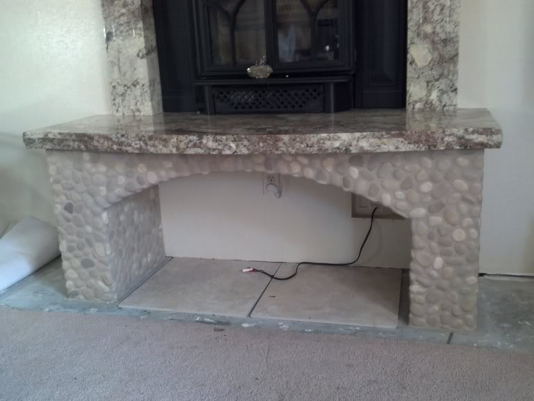

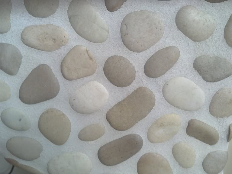

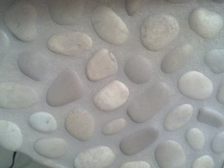

I did this one today.
new install but the lady did not like how the white grout coincided with her granite
So Kahlua Cream to the rescue..
Some dude from San Jose wanted $500 to do it.
I had a slow day so for $250 I sat there and painted the grout (truck never got involved) and talked motorcycles with the hubby for a couple hours..
