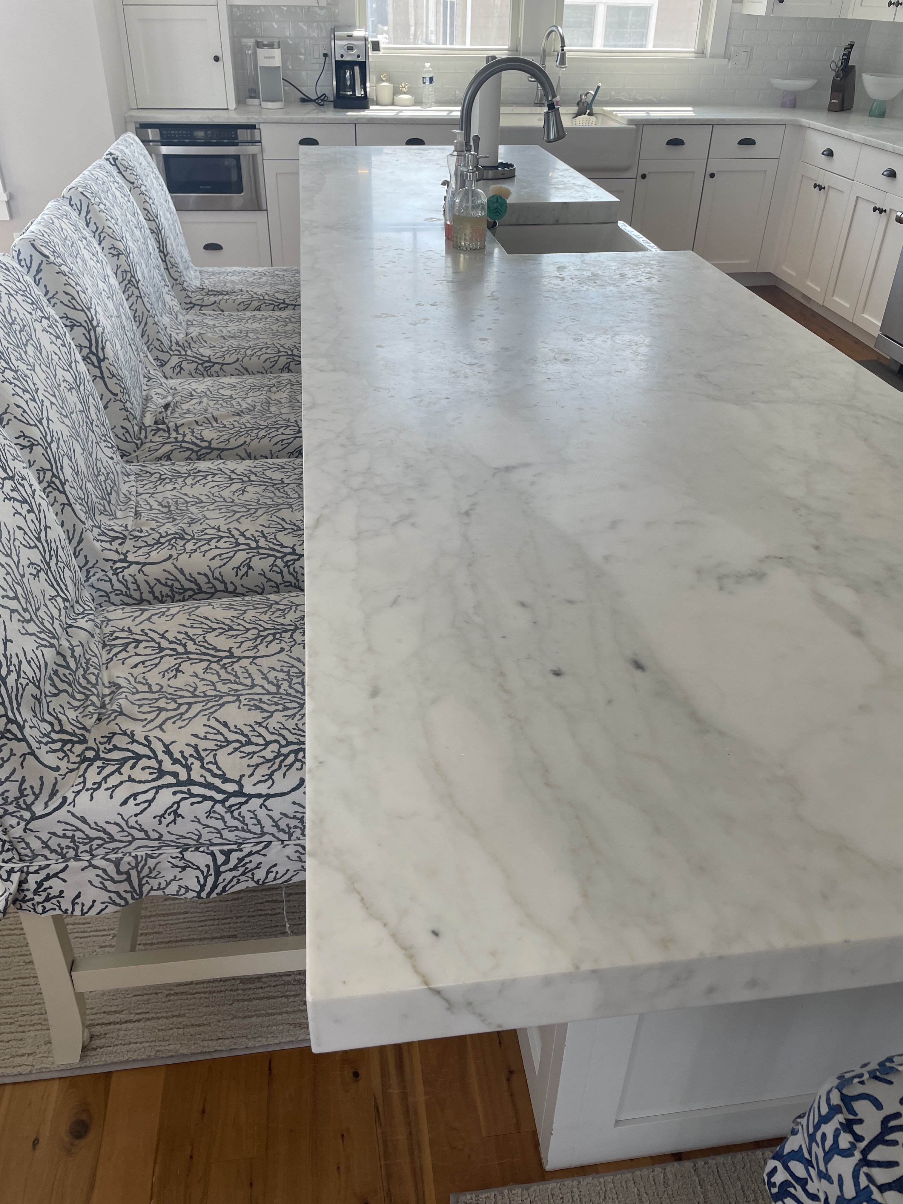

Is this "EZ" to fix
Mike J
Feb 21, 2022
1,326
East
Mike Joannides
I noticed the surface damage to this counter when admiring it. How difficult (for you pros) and how much coin could I make if I fixed this. The picture shows it but worse in person.
I think I may be a total stoner at heart.
112,628
you can fix that marble with a bit of training and practicing in your garage but they will continue to etch it.
Every liquid in the refrigerator damages a soft calcite stone like this.
and no, sealing wont protect it.
MB Stone offers training to apply a very durable "antietch" coating on marble counters, that hotels and restaurants sometimes chose to do when the anal owner can't take it anymore
Something to look into for when you body starts to fall apart from slinging a wand
