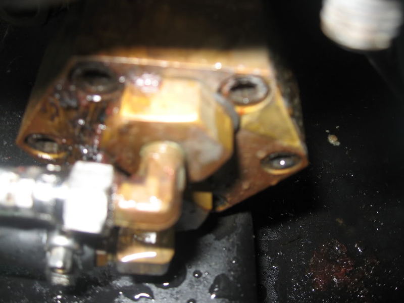

Ok I replaced the diaphragm and that wasn't the problem. I didn't see a problem with the one in it but I changed it anyway. I tightened everything back up and tried it out. I filled the solution tank with water and it gushed water everywhere from the top right of the chem pump. There is a small rubber ring that connects one of the two lines that feed solution or whatever they do. I think it has been pushed out and has sprung a leak I'm going to try and pull that off if I can and see if I can get it to seat properly for now.

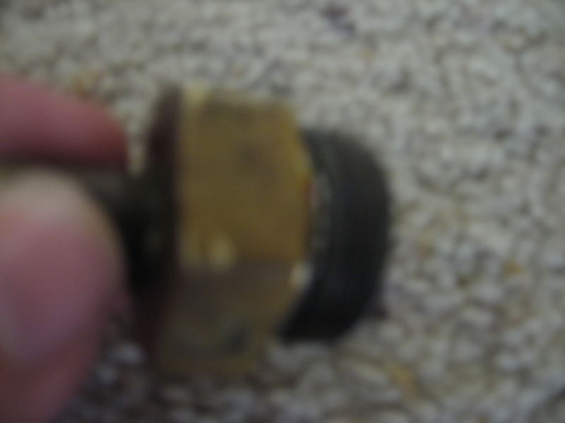

I tried Ace. Remember I live in the woods so finding crap is next to impossible and I don't want to drive 2 hours total when I can just have it shipped to me.
Here is a better picture for the Macro A-hole.

post me a picture of the pump itself so I can see exactly which one you have....If it is the same one as a few old ones I have laying around I will pull the fitting and send it to you.......I also noticed in the picture there is no O-ring on the fitting.....did you take it off and forget to put it back on when you put it all together..............

I took the o-ring off for the picture. I was going to try to reseat it then replace the ring but I found that the fitting was cracked. I've got the fitting on order and I should have it tomorrow. It would be too much trouble and costly for you to send me one. I appreciate the help Jim. Anyways I should have the machine ready for next week.
