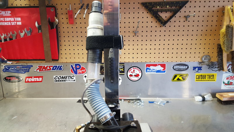

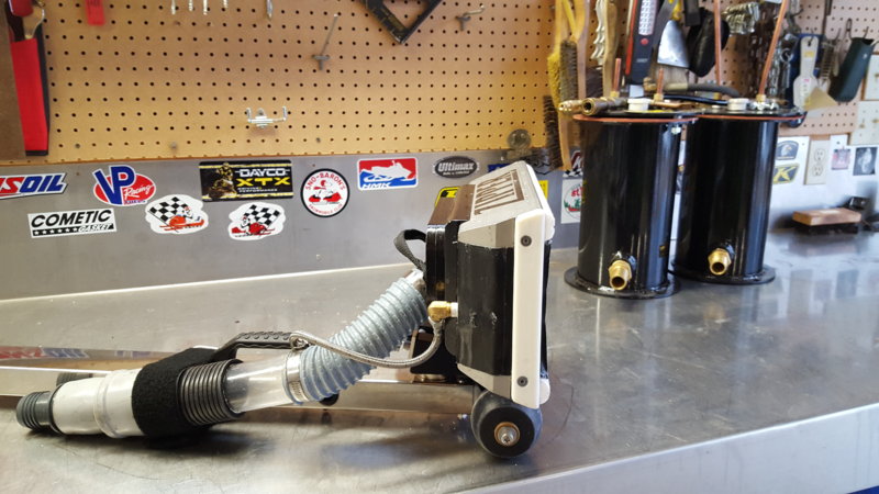

The first thing I did with my Zipper was to remove the hose from the handcuff on the handle to let it lay on the floor. I made a 1' whip that is held in place by the SS Hp line so the hose exits straight back towards the operator. Eliminated the need to always having to operate one-handed. The next was to skirt-in the sides to eliminate the 'puff the magic dragon' effect of the escaping steam vapor. Total encapsulation of the solution so as to not overspray onto various household articles as you are going by them. I also swapped location of the carry handle and made a nylon strap to attach under the two allen screws holding the weights to the cleaning head.
Much more ergonomic as opposed to the stock set-up.

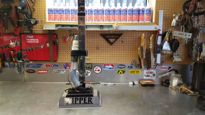

Sorry, no pictures. The whip that I made starts with a 8" section of the grey, wire braided flex hose used in the confined spaces of portys. Install the sight tube and clamp. A 4-6" piece of the supplied vac hose with a swivel cuff finishes. This can be routed under the SS HP water line to control movement. This set-up now like a wobble extension that exit straight back.
For the skirting, I used Gorilla tape, a crafters exacto knife and a little patience to contour over both sides and on the inside of the head so nothing would stick. Both glides are still removable. I saw a video of the new SS Zip where it looks like Eric has machined HDPE end caps. Would be a great add-on.

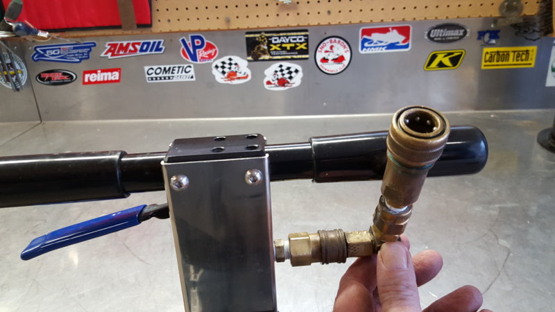

I also added a swivel feature for the HP water line to the valve on the handle. The unit can now lay completely flat to the floor when needed.
Hose management is simpler now, just lift side to side as required

Thanks Mark. I'll try to get some more up later today. As you can see the swivel starts from the valve with a close nipple to a flow-thru female connector. The adapter starts with a male flow-thru to a 90 then to a standard female QC. The skirting does'nt show well but as I explained to Mikey, I just used a contour gauge to outline the Zip head and enclosed the sides. It is also reverse taped on the inside so nothing sticks.
