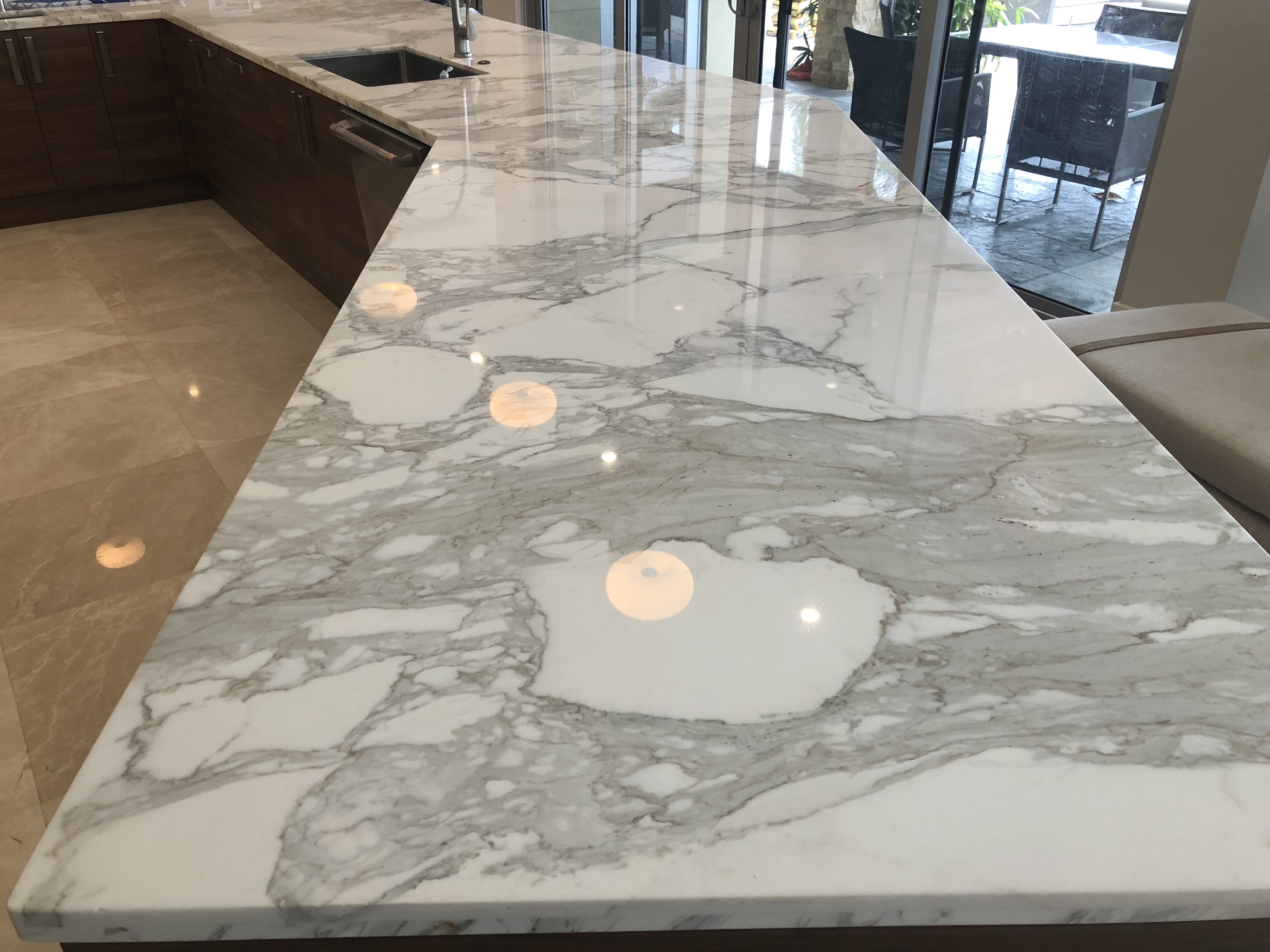

  7. sincity870
    sincity870
    Joined:
    Dec 21, 2014
    Messages:
    10
    Location:
    Las Vegas
    Name:
    Jeff
    with the proper tools you will love it. Here is an example of resins and powder on marble bath counter..
    Sierra Clean Care likes this.
