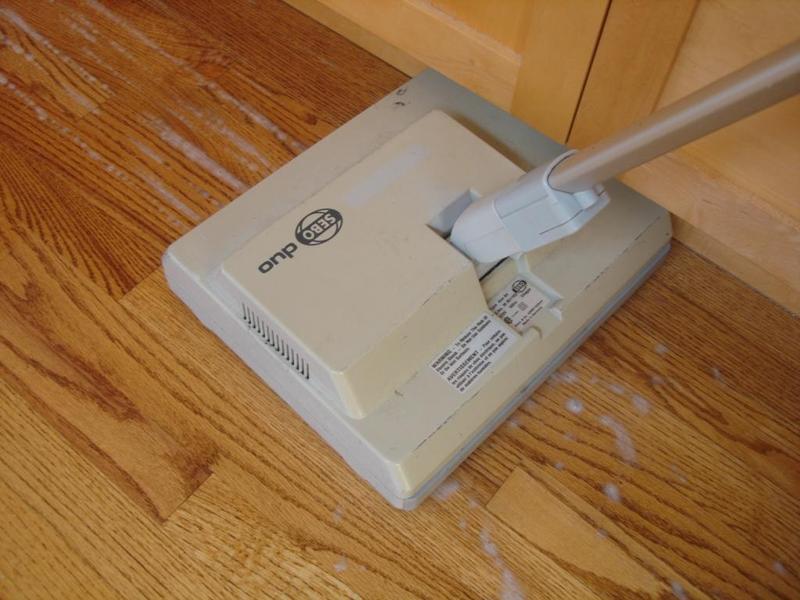

So I used my Mytee sprayer and mixed the Squeaky Cleaner to spray the floor and then followed it with a mild Whittaker GLS scrub. I shortly found out it went easier and quicker with the Sebo with the added advantage that the Sebo would go under the kitchen cabinet kicks. The electric sprayer worked perfect for this.

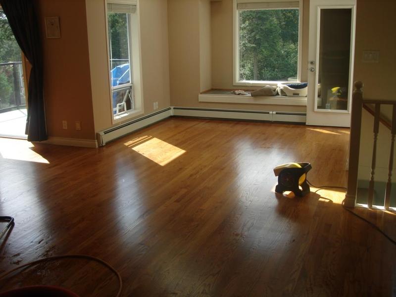

I then rinsed the floor with cold water and 250 psi with my Mytee Bentley wand. Next I dried it using a couple of fans.
I divided the scrub and extraction into three areas and by the time I finished scrubbing and extracting the second area the first area was dry so I could move the fans to the second area.

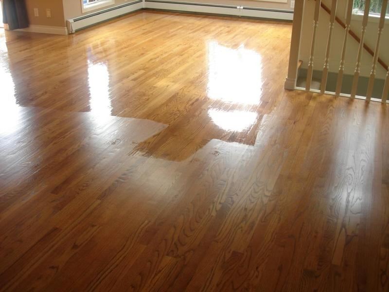

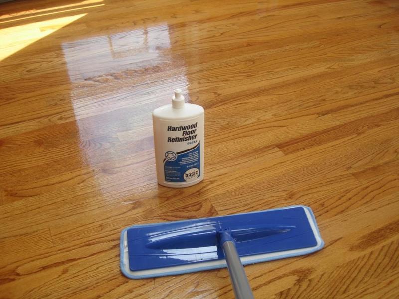

Next I put on the refinish which you just drizzle on to the floor with a squeeze bottle and then apply it with a micro fiber finishing pad.
The job was just starting to kick on the first section when I left but I could tell it was a big improvement in the doggie scratches which was her complaint.

Yes its still wet in the pictures. One of the pictures you could see the material starting to kick near the window. They say one coat is good but you can put more on.

In the last pic the area closest to the window seems to be dry but also with little shine. I am sure just cleaning the wood made a difference, but what did you tell the custy to expect visual-wise? And what did the Basic company tell you about how the finish that you used would stand up to foot traffic and how long do you think it will last?

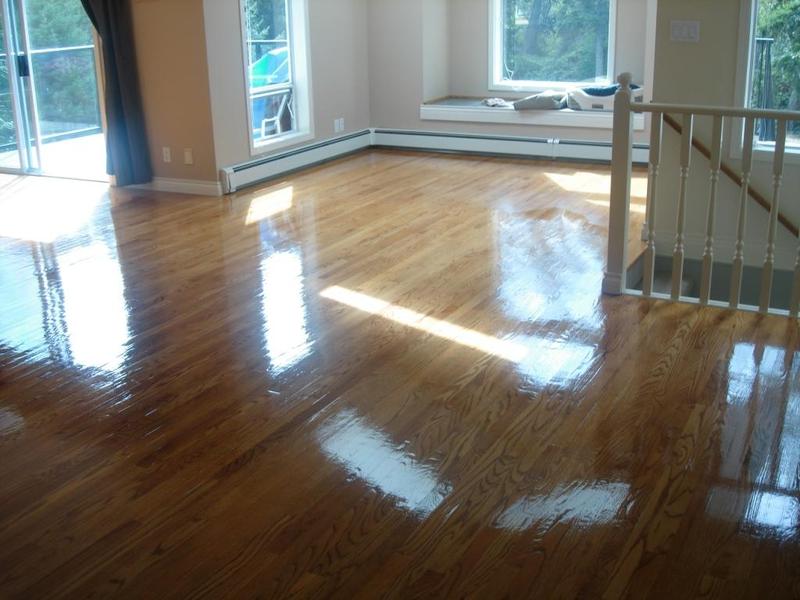

Today I went back to look at the job and pick up some fans.
She is over the moon with the job. And so am I. So before one of you freaks pisses in my cornflakes and says lets see how long it lasts.
Let me say lets see how long it lasts.
It dried hard and non waxy and it wasn't 24 hours yet.
Beautiful!
