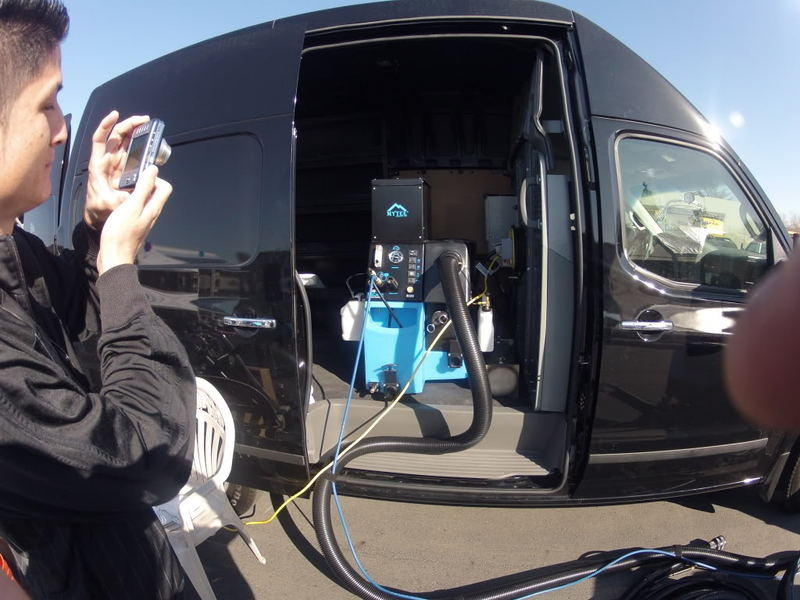

This rig at MikeFest was very impressive. John has broken serious ground here with this new machine. 16 1/2"hg and 300 cfm! With 100 ft of hose it was pulling strong. Pump out, 1000psi solution and dual heat exchangers.
Larry Cobb
5,795
Dallas, Texas USA
Larry Cobb
I have not heard about the dual HX's.
What type were they ?
Any photos ?
Larry

Hi Chad:
I'm interestd too, in the heat exchangers?.
And how did we get the CFM figures?
How many amps do the 2 cords pull?
Sincerely,
Dale

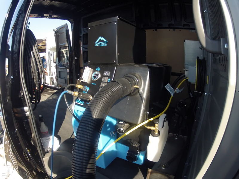

The Black box at the top left has been added since Connections.
New electric vac designs can easily develop 16.5" hg.
http://www3.cobbcarpet.com/zen3/index.php?main_page=product_info&cPath=68&products_id=4725
We just helped a customer finish a trailer-mount electric with 4 vacs.
Of course, the vac levels will drop when flowing hundreds of CFM.
John has a portable CFM guage.
Portable HX's have been around for years.
Thanks for putting up the photos.
Larry

I only see one cord in the picture.
I would think with 15 amps circuits:
The main unit with 2 vacs and a pump would take -two cords
Heater -one cord
Vac booster (black box)-one cord
Four 15 amp cords total.
I guess you could run a generator.
But, then you end up just running an engine like you would with a conventional truck mount.
Then you lose many of the benefits of going electric.

This is the new Mytee hybrid Escape Plus ETM. We have an 11,000 watt military(these generators are use on Humvees) type generator mounted and powered by the Nissan engine. they produce a clean sine wave so you can even run a computer on it. The engine cooling system also heats the solution by means of heat exchangers. We maintain 160 degrees using a Rotovac 360. this unit is a quad vac 16.5 hg and 300 CFM. 1000 psi General tri-plex pump, 70 gpm pump-out pump. So yes we have to run the Nissan engine to produce the power but no power cords are needed to be plugged in. As for fuel consumption I don't know yet we just installed the day before Mikeyfest. However, the generator company stated that the consumption would be 50% less than a 11,000 watt be gen/set with a gas lawn mower engine. Even the 360 plugged into the power module. $10,999 is msrp.
30,668
We have an 11,000 watt military type generator
Heater -one cord
The yellow cord was an extent ion cord for the floor machine contest. They just used our ETM to power it.
Shorty; Powerclean in Austrailia it carrying the unit. They should have them soon.

The unit I demo'ed at Mikeyfest is somewhat like a PTO.
1) Requires 230 volts about 33 amps
A- Quad Vac 230"/16.5 hg, 300 cfm
B- 1000 psi General tri-plex pump
C- 70 gpm pump-out
2) Heat exchangers use the truck engine to heat the water (yes it uses gasoline)
3) Generator on the truck engine produces 11,000 watts. More than enough to run the unit and power a rotary if needed.
Cost breaks down this way:
Escape Plus ETM about $4500.00
Heat exchangers about $1500.00
Generator is about $5000.00 Yes, the generator is initially expensive as generators go, however, consider this. This unit will last much longer than a conventional genset with out the maintenance cost of typical gens. It uses gas from your truck tank, but also heats your water. Set up time is typical to a regular TM.
MSRP $10,999.00
Maintenance on the ETM is very economical especially compared to a regular TM. One guy at Mikeyfest had just lost his blower and needed repairs on his heat exhangers on his TM and had to go to Utah from Cali and it cost $10,000.00 for the repair.
On the Standard Mytee Escape ETM 115 volt with dual powercords
dual vac 144"/10 hg 230 cfm
500 psi General Tri-plex
70 gpm pump-out
MSRP $3599.00
Both units have a 2.5" vac inlet that can be reduced to 2" for max air flow.
This unit is on the website. Look on the Presidents Club catalog.
No machine is perfect for all but the new Mytee Escape and Escape Plus is a push in the right direction.
