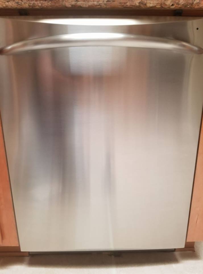

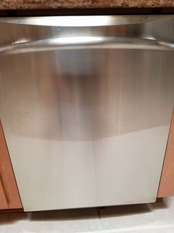

Can anyone help me with this.
I had the dishwasher masked off 2.5 feet up. Everything above the plastic is now dulled.
The chemistry was either Modern Stone Easy Etch or Stone Pro quick clean.
I know I did not spray and chemistry onto this dishwasher. There is not spots or drips. The color change is very even.
The only thing I did different on this job was I didn't use my pump up sprayer, bad gasket wouldn't hold pressure. So I used by battery sprayer. I didn't spray full force but it was a little stronger then the pump up and sprayed a cone pattern.
The other really odd thing is the discoloration didn't show up for 3 days.
What caused it and most importantly what can I do to fix it.
I am really hoping I don't have to buy it.

Travis, I don't know what those products have in them, but my guess is that they fumed and caused the slow reaction.
Try oxalic acid, the product is "Barkeeper's Friend." Stroke it with the grain. I bet you the discoloration will come right off. Neutralize with an alkaline cleaner, then rinse well. Or do both with ammonia glass cleaner.
Then for God's sake, use appliance stainless steel polish on it, to build a vapor barrier on the surface.
Let us know how it goes.
If you have to use steel wool, use stainless wool at a fine (000) grade. Go with the brushed grain and don't make cross scratches.
Heart of Dixie
Travis, mix the Barkeeper's Friend with Hot water in a bowl. It is like skim milk. Dip a microfiber and work from the bottom up, as if you were polishing brass.

I see a something different, maybee it's the lighting.
The plastic removed the "patina" from the SS. As I see it, the bottom 1/2 was covered in plastic
I am actually not sure what that means, but the bottom matches the other stainless appliances in the kitchen. The top part is the discolored area.
Just out of curiosity what would you do if it was the patina

Only thing I can add is that I have had the two foot tape and plastic make quite a few marks on stainless lately. Not all stainless but a few.
Usually it goes away with a stainless spray polish.
When I first looked at the picture, it looked like the stuff I typically see under the plastic. The top area looked normal.
