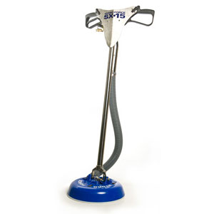

I have proto/beta in my hands and am curious what you owners of the SX 12 did not like about yours
I have not used it yet but I'm liking all the features.
Brush rings comes off sans tools, vac port is easily adjusted, Nice big vac ports, 15 inch head, 2 inch tube shiteatinggrin

vac holes are a bit small on the SX-12 and clog easy.......
the brush on it will aerate and makes your chemical foam up a bit

I've had it for quite awhile. It is 80% there just a couple of tweaks in my opinion. Not 100% sure if any tile tools need 2"' tubing and the 15"'head sounds good in theory but I'm not out in the real world so Im not sure if a bigger head is needed either. Other then that it looks like a winner so far.

Yup when the vac slots are just too small that could be a very costly thing.
Example: I was finishing up a 2 day stone polishing job, when I only had to clean the last 40-50 sqft after it was polished. An accidental small piece of grout -or speck of stone from somewhere- got stuck in the vac slot and I didn't realize it as I was working with it. Couldn't feel a thing! as it was dried up you could see exactly which direction the tool was sliding with perfect scratches showing the way.... :shock:

I've had my sx-12 for 3 years and there's nothing I don't like about it.... works great and has been reliable. But I haven't used anything else. The vac slots are fine, but I always sweep and vacuum before cleaning with it. The 2" would be nice, right now I still need to carry a 1.5" whip just for the SX-12, so 2" would eliminate that.

1.suck down to the floor and I would have to release the vac port in order to get it moving again. Havent ever had that happen with the turbo. The sx-12 sucked to the floor so bad once that the spinner hit the tile and left a nice circle. :shock:
2. couldnt get it to lay down flat to go under chairs and other things like the turbo does.
3. side slots wold get clogged with stuff a lot. Never had a clog with the turbo.

That's because your brush ring is dirty and not letting air flow through. I had the same problem. Just scrape the gunk out or put a new brush skirt on.
My complaint is the airflow sucks. Leaves the floor too wet.
That and the holes would clog.
Also it does not fit under toe kicks.
With that said the gecko is by far the biggest pos tile tool ever.
I'm with Daniel on this one. leaves the floor too wet on some jobs. I always have good airflow. I cleaned a 1300 sf limestone floor on Monday, and brought a new mop and ringer bucket to help dry the floor quickly, along with a fan.
It would be a great help if they could get this tool to clean closer to the wall, like within 1/4" or so.

i drilled the holes to a larger size , no more problem. fits under all cabinets here unless they lay stone over some tile. it also lays nice and flat. Did you guys buy from the reject pile? :lol:

Just picked up a improved from flex sx 15. Really like the turbo force from the good reviews but decided to give this mofo a try.

They missed the mark by 1/2 on this tool. The cleaning path is like 11.9" On a 12 tile having a 12.5 or 13" path would save time by covering 2 grout joints at once. For refernce a 12" turbo will leave a 10" clean line. Anyone know what a 15" turbo will do?

Why do they need the 2 handles? Seems like they would get in the way around corners and doorways. I use a turbo but far from loving it. The gekko is needed in tight areas.
