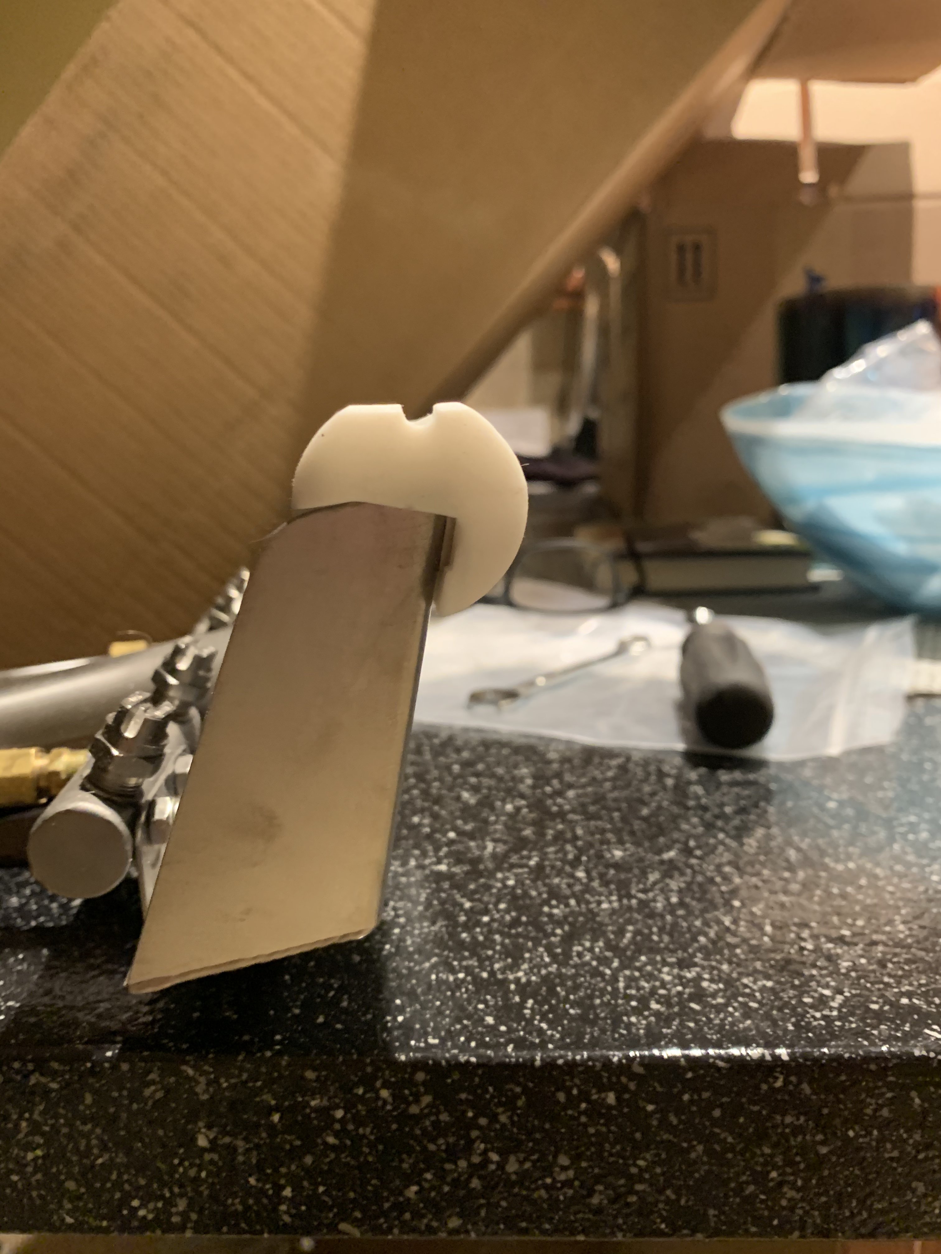

Yep six flow is fine on that one and if it locks down on you get rid of the PMF glide on there that's too wide and it doesn't have any relief on the ends and get a greeny glide for it
These channels on the glide aren’t enough? The go all the way through the glide.

No, those channels are not enough as they will be buried in the carpet..
You see where you can't see the corner of the wand there? That's their way of keeping it from moving side to side. but it effectively removes a little bit of vacuum break that we design into our glides to keep the air flowing

No those channels are not enough as they will be buried in the carpet a lot of times You see where you can't see the corner of the wand there That's their way of keeping it from moving side to side but it effectively removes a little bit of vacuum break that we design into our glides to keep the air flowing
Thanks. I’ll try this glide tomorrow.
I wonder why the Evo doesn’t lock down.
Because it also doesn’t pull enough water out of carpet?

I actually like the glide, except for it’s an eighth inch too wide on both sides.
