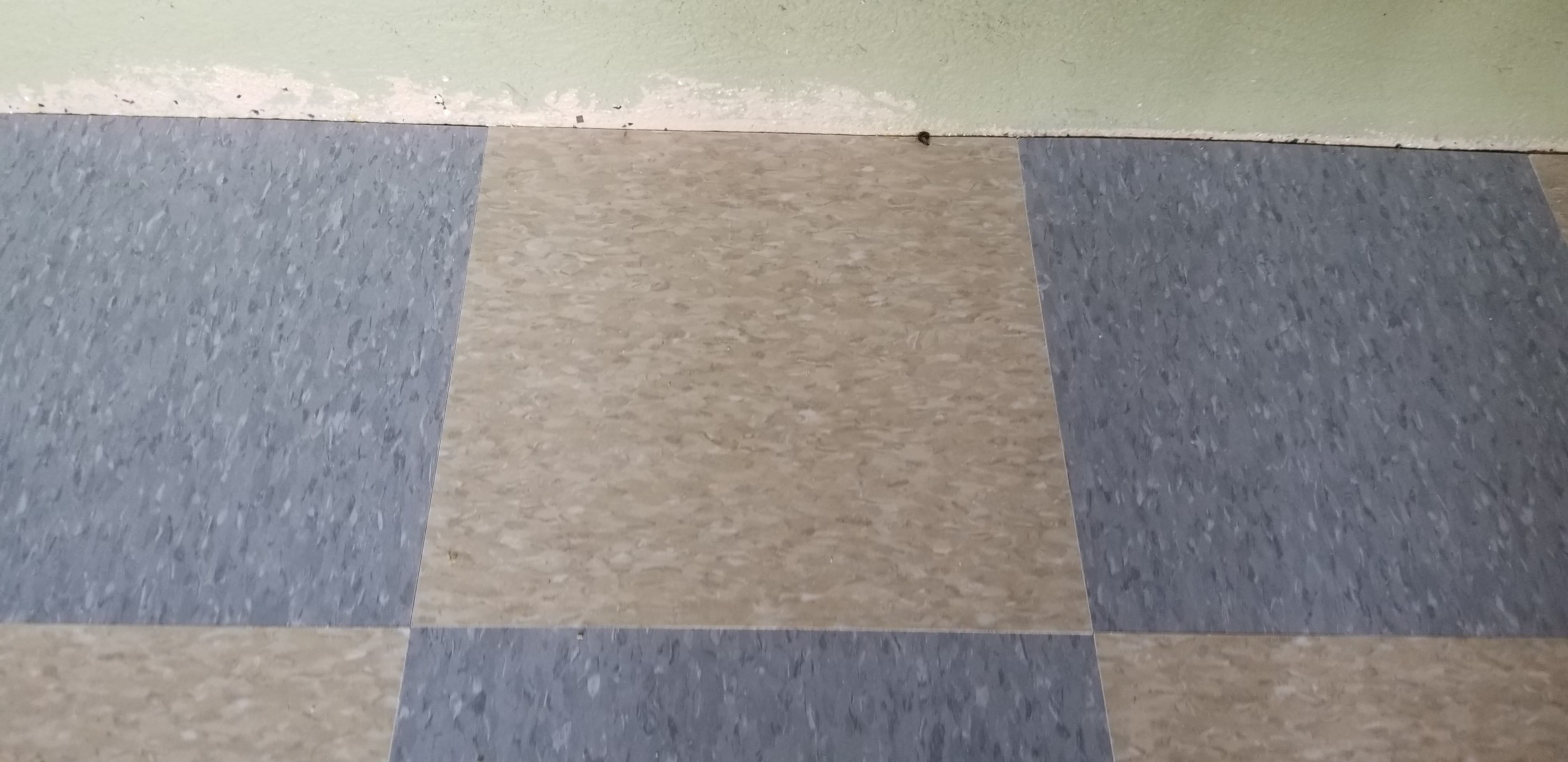

Hey all,
I just finished installing VCT on my garage/ shop floor (19x19). I'm a Tradesman and have installed what seems to be miles of VCT in my days. However, I was never there for the final finishing in order to see how its properly done. So I'm here to ask, What's the best way to finish my floor high gloss shine?
I installed Armstrong vct, Install was a breeze as usual, I do have 3 small areas that have a a little glue residue. ie;
2' thin line sections pencil line thin with glue residue.
Am I going to have to rent a Floor buffer in order to properly complete?
which brand of Acrylic/ wax would you recommend? Solids % ? etc
will it need to be stripped in order to remove the factory finish as well?
Upon starting how much time is needed in order to complete and drying time between coats and before placing everything back into my shop No car's. Table Saw, jointer, miter saw, band saw, Big heavy work bench, etc. Most items are on wheels, caster's except workbench

make sure glue has cured fully before applying floor finish .
( a week or two depending on drying conditions)
remove surface glue residue with acetone or lacquer thinner
(if heavy, slice off the top with razor blade first)
don't need to "strip" with stripper, but there is a manufacturing residue that should get a quick scrub and rinse off before applying finish
I've used neutral cleaners for that
any janitorial supply stores near you?
They'll have pro floor finish
start with a clean dust free floor and apply thin even coats with synthetic string finish mop or pad applicator
(also available at JanSupply store )
after the third or forth coat, it will start to shine
won't be fully cured for days
but you can start moving light furniture and gear in the following day
if you want it to "pop" and look like deep wet glass, rent a hi-speed burnisher after the finish has had a month or so to fully hard cure

We do a lot of floors. Do a light scrub with any neutral cleaner, bule/green/brown pad, Rinse with cold water, dust mop & apply 3-4 coats. Want great results? High speed buff the next day & apply 2 more coats after the buff. We like Spartan IShine. Don't get caught up in the solids......I don't pay attention to it because who can prove it?

Like already stated, let the floor off gas for at least a few days. Then scrape the glue off. I would scrub with a green pad and some neutral cleaner, then apply a sealer if you want. I would go to your local janitorial supply store and tell them your needs for wax. Every supplier has different brands so you should use what's local. Give it 4-5 coats of wax with an hour or so to dry between coats. Then give it about 48hrs before you put heavy stuff on it. Those are all optimal times. You can rush things if necessary.

Renting a 175 RPM floor machine will definitely speed up the process over hand cleaning. Probably worth the cost. You can rent from Aramsco on Amelia St in Orlando.
As Larry says, every brand has a neutral floor cleaner. They all work. If you are at Aramsco or Interlink - Viper 7.
A light scrub to remove the factory applied finish which is meant to make the tiles easy to handle during installation and not stick together. Mop or spray on your neutral cleaner. Scrub with floor pad, probably blue. Extract or flush to a drain. Rinse with fresh water.
Apply your finish. I suggest 18% to 20% finish. Higher solids can do a good job but are a bit thicker and not as easy for a first time user to spread evenly. Several coats with 1 hour or more between coats. In humid weather, maybe 2 hours or more between coats. Thin coats. First and last coats go edge to edge. The middle coats can stay 6" or more off the walls to prevent build-up along edges.
I like to go with the know national brands such as Johnson, Butchers, Betco, etc. You know they work. Local products often go for cheap rather than quality.
This can be polished with a high speed buffer if you want more gloss. Keep in mind that the glossier the floor, the more any scuff or damage from traffic will be noticed. Consider just a light shine that will be easier to maintain.

I apply two past awesome (6 coats). The main purpose of finish on VCT is to protect the tile, the first two coats will accomplish that purpose. The next two coats will make it look awesome and the last two coats will protect that shine. When applying the finish their is big difference between it being dry and cured. To knowb if it has cured enough before you put on another coat of finish, after it has dried go stand on it and contemplate what great job you have done. As you lift your foot LISTEN for any sound that indicates that your foot stuck to the floor, if it did wait before applying your next coat, Repeat for every coat. If you do not wait long enough between coats it will begin to streak. More coats will not fix it, you will need to buff them out before proceding. If you put anything with rubber on the bottom (tires, etc) place something underneath, the oils from the rubber will leach into the finish and you will end up with yellowish brown spots on your nice clean floor.

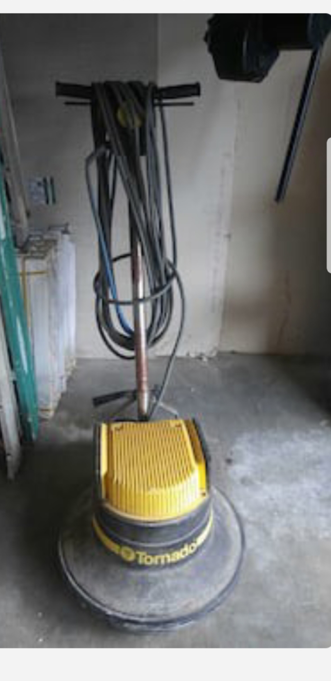

I've been a bit swamped with work lately, I came across a used buffer that's for sale and was wondering if this may be a good deal to buy and to hold onto vs renting at $37 4 hrs each time I may need it.
the guys selling it is asking $150

Tornado brand has been around "forever"
If it runs, and the drive block (the large round removable piece under the machine that holds the pad) is in good shape, it's worth $150
Offer him $100 see if he bites
lemmie back up a bit
do you know what RPM it is?
175 rpm is best for scrubbing and striping
Higher rpm is better for polishing maintenance

Yeah. I asked if that was the best he can do , as far as price goes and says he can't go any lower, as he paid over $1k for it, and that it runs as if it's still brand new, no problems. I'm sure I'll get it down to $125.
its 175
