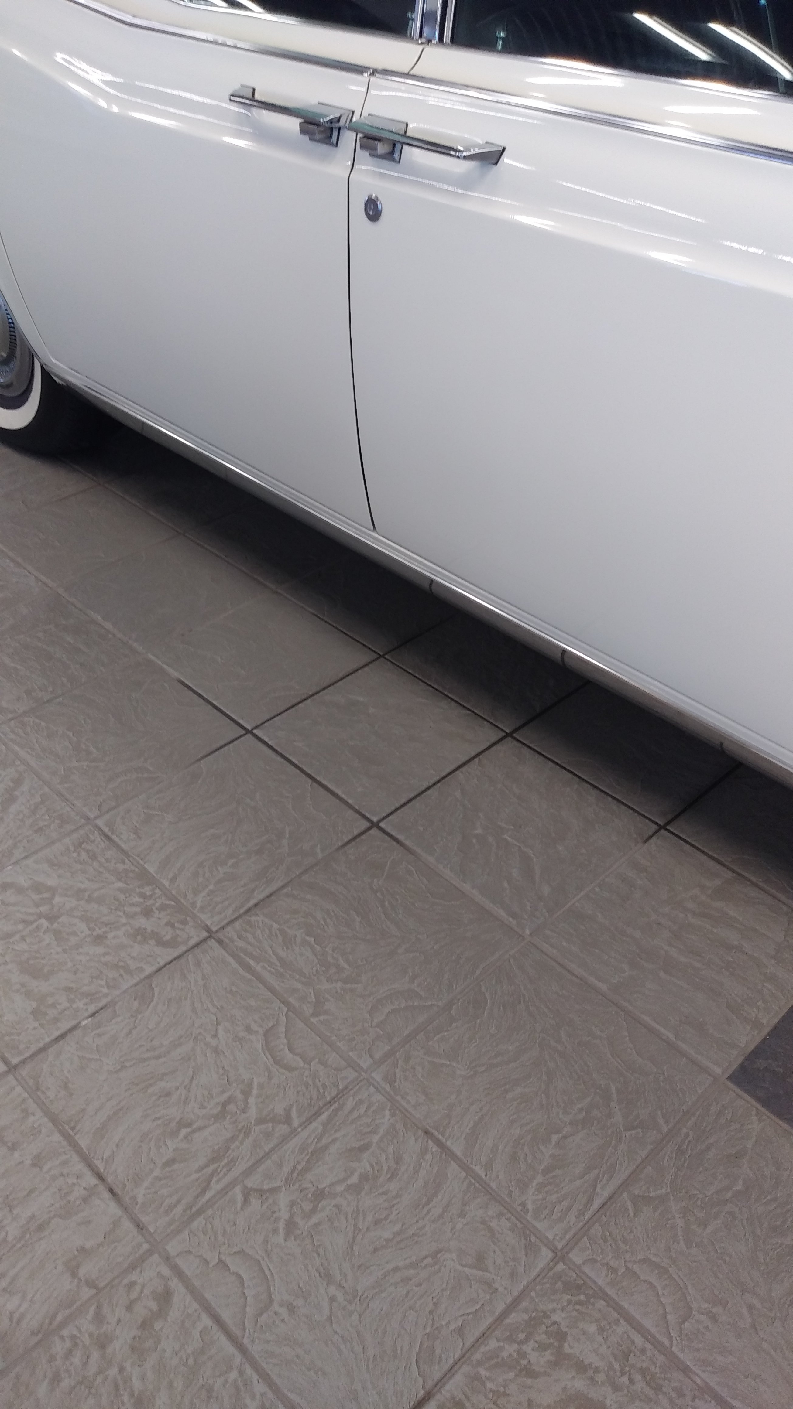

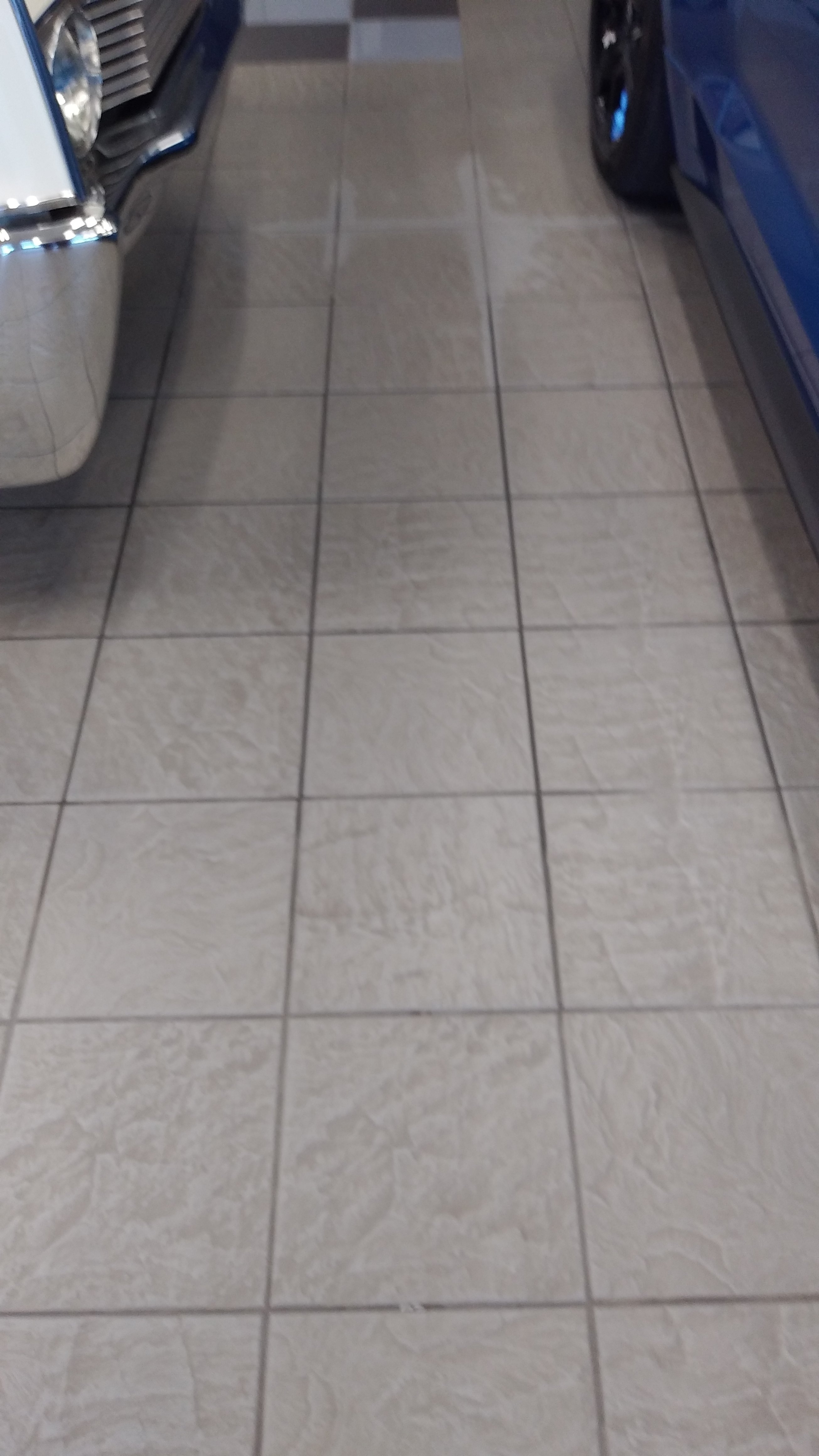

Any advice on getting motor oil stains out of grout?
The dealership had a couple old cars on display for about 6 months or more that leaked oil all over the floor.
Any advice is appreciated.

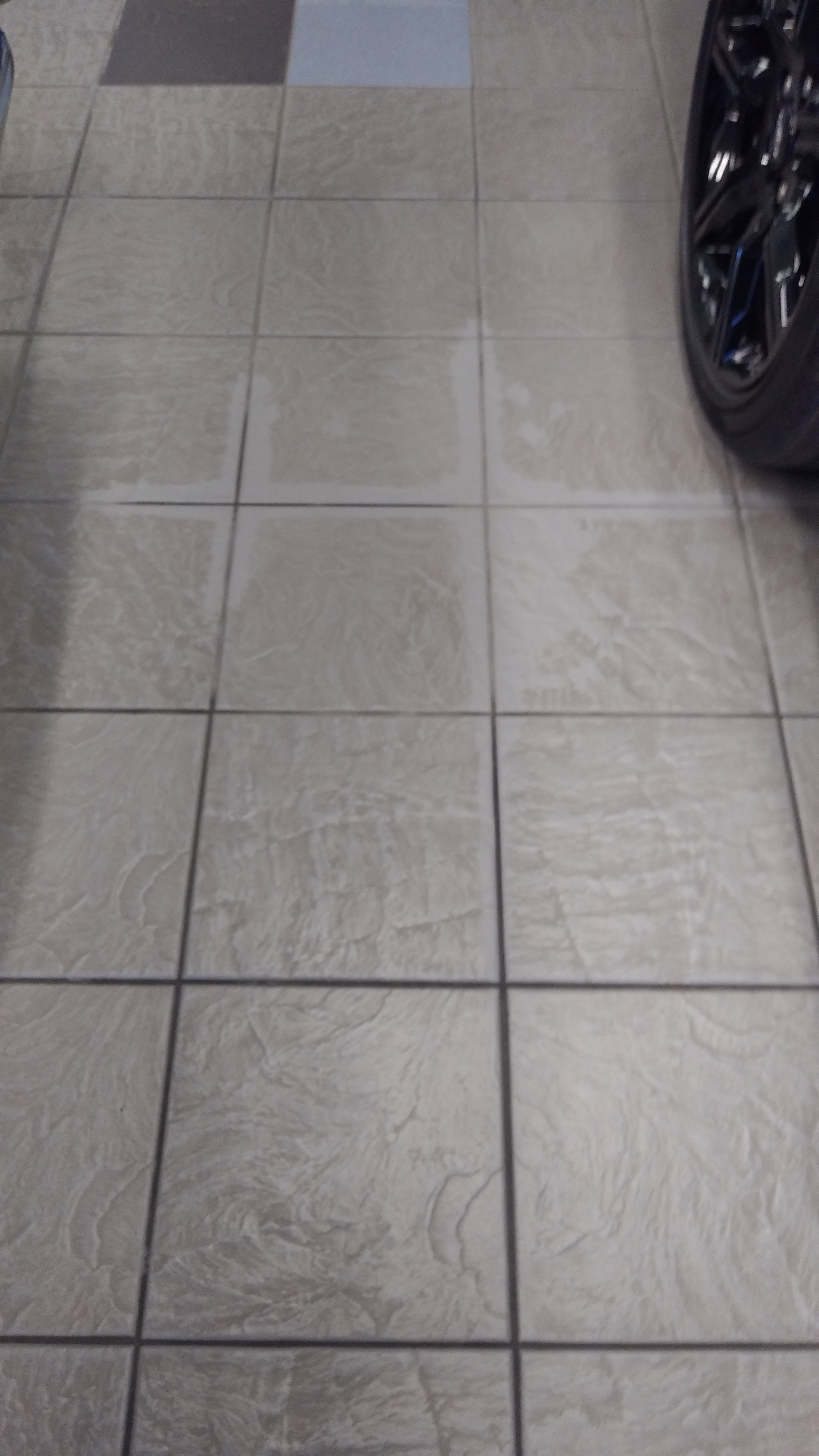

A lot. 2 areas about 50 sq ft roughly that need a lot of work.
Tried the viper line peroxide and renew. The renew got the tile clean easily but the grout lines aren t coming out very well. The peroxide didn't help much on the initial clean.
They ran a scrubber over the whole floor the one they use in the mechanics area and it looked like Crap.
I'm trying to get these grout lines clean so I can sell them on letting me do the whole thing.
I've got the viper citrus powder coming. Ran out a few months ago.

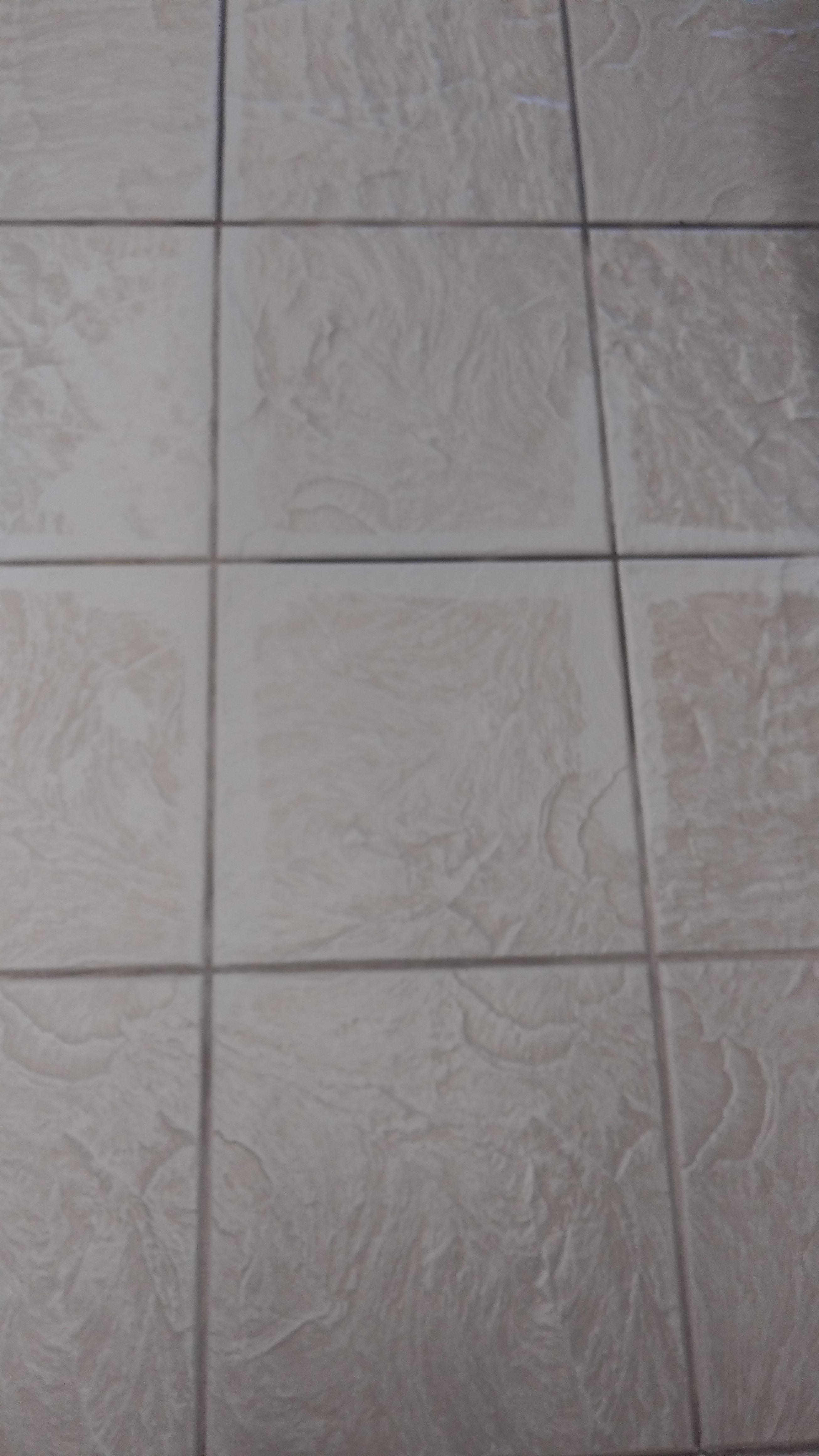

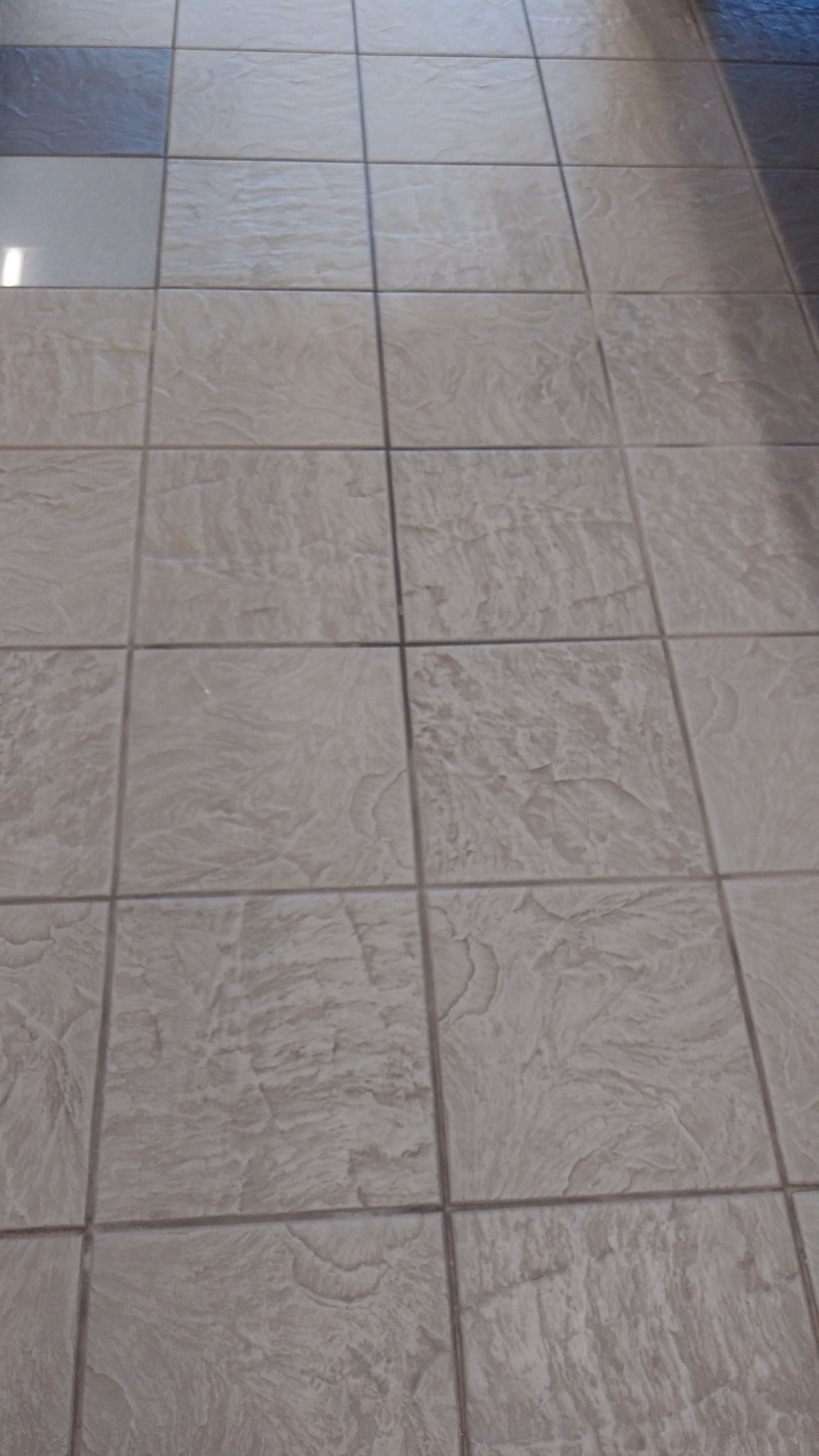

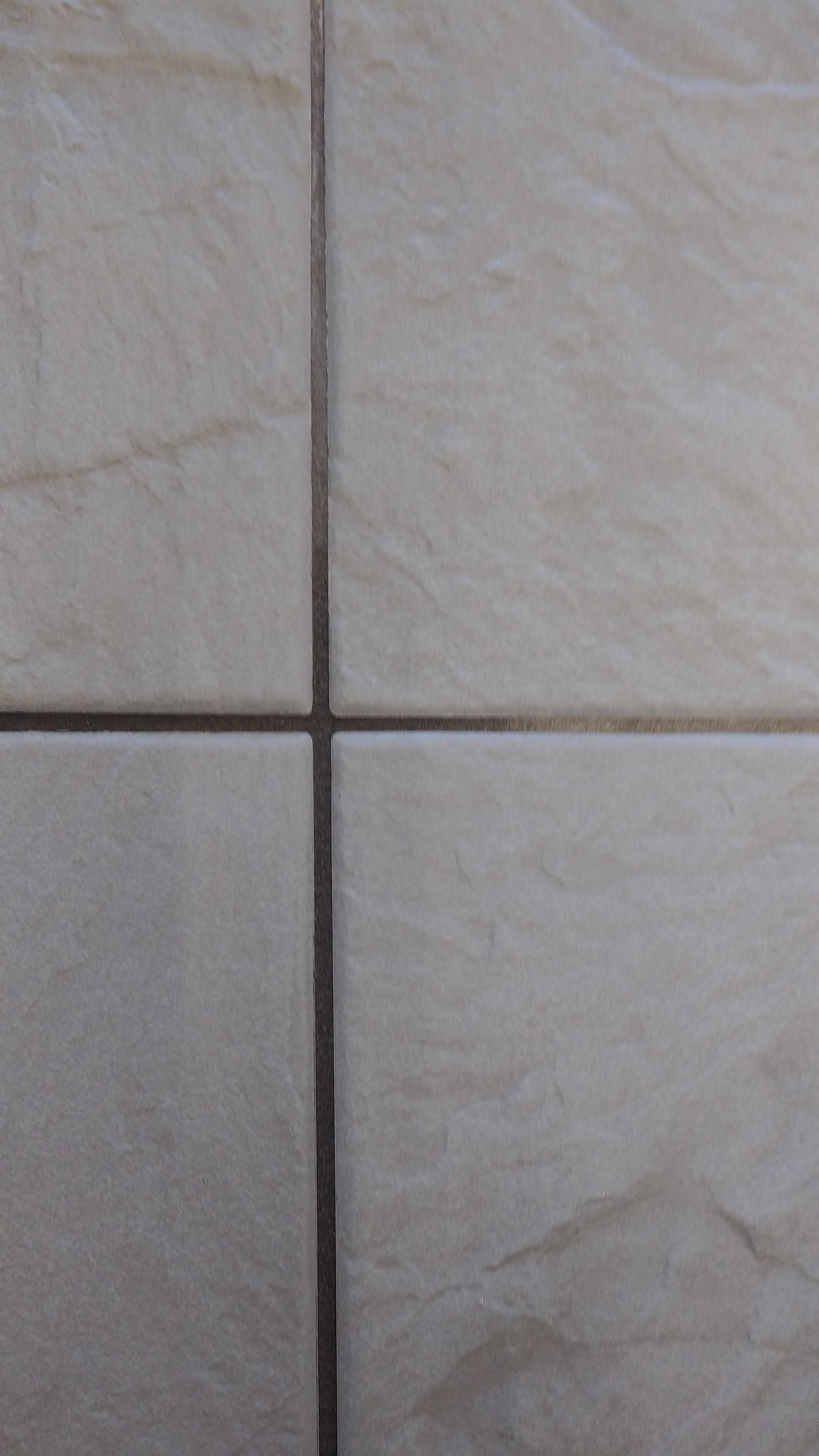

They just moved a car for me so I could see this area better. I worked on it a couple weeks ago.
I did scrub this area better and it looks like it turned out better but still didn't get it all.
